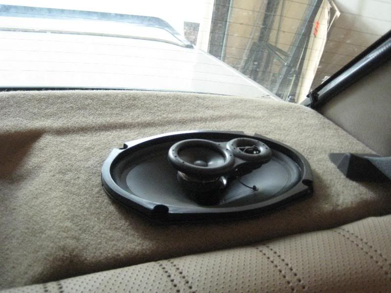

November 10, 2009, 03:57:56 PM »
heres mine. I just brought the speaker surround up with MDF, cut the speaker holes and anchered it inplace. you have to check the measurements to make sure theres enough room with this approach. Crutchfield has pretty good measurements of what size the speakers are. After all that just use some foam to shape it and some fabric. pretty simple but time consuming.

November 10, 2009, 11:41:35 PM »
This will give you better (ie: louder) "sound" but it will all be coming from the rear and not be a sound quality way to go. Rear speaker are supposed to be for fill only. These will completely over power the fronts.
