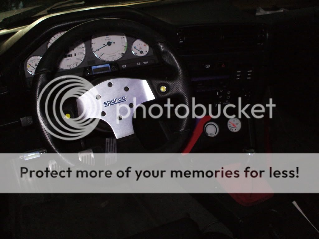

Boosted E30
  • Posts: 225
boost gages post your pics
« Reply #8 on: October 15, 2009, 07:18:05 PM »

« Reply #9 on: October 15, 2009, 11:09:40 PM »
^Like that too... where did you get the gauge overlays in the cluster?  Been looking for silver or white ones that were decent.  ie non ricer...

« Reply #10 on: October 16, 2009, 10:45:31 AM »
I just want to know where he got the gauge needles, or if he painted them.

« Reply #11 on: October 16, 2009, 01:40:10 PM »
I took the whole cluster apart and scaned the gauge faces onto my computer and made them how I liked and then printed them out on photo paper, at night they light up completely red looks cool. The needles I just painted with a permanent marker. If your goin to try doing this be very very carful when ur pullin the needles off it will break very easy.
