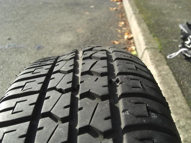

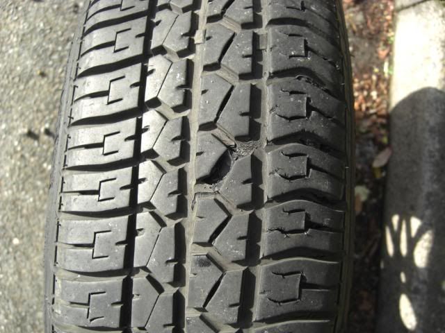

carlos318is
  • Posts: 320
Need your help please
« Reply #6 on: October 04, 2009, 05:45:07 AM »
Well guys it looks like you were right all I can say is holy fuck as at the time  I had kids in the back of the car and the other half  in front and I was racing at the time :eek:
roundel318
  • Posts: 512
« Reply #7 on: October 04, 2009, 12:54:15 PM »
Nice bulge, get it fixed :)
xwill112x
  • Posts: 691
« Reply #8 on: October 04, 2009, 07:59:24 PM »
good burnout tyres!
