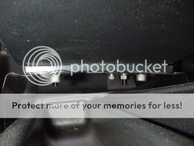

The arm rest was a pain in the rear.  I found that turning the cover inside-out and rolling it on worked pretty well.  It is really tempting to make an off-color comparison to another activity that this is similar to, but I have said enough already.

I continued with the rear seat back.  This was, by far, the most difficult part.  If you own one without an arm rest, this will be considerably simpler.  I swapped in a fancy one, so I got to pay the price when I did this.  You will notice that the upholstery is fastened with a combination of hog rings, and metal spikes.  Getting the little seat belt cubbies out was tough as well, and I busted one of the little plastic pegs on one.  Getting them out seemed to be easiest by hammering a small flat blade screwdriver through form the back, bending the little locking metal tabs the opposite way.
