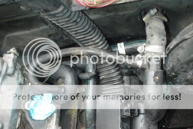

So, I only have this one picture, as I had to buy the "j" shaped hose.
I did end up cutting the hose in the foreground going into the T fitting by about 3.5"  to become the hose on the other side of the t.
So,
the answer to question #1 is upper heater fitting.  <-----Correction  The lower hose goes from the block/head to the aux thermostat to the lower heater fitting.  Just went outside to check.  :D
the answer to question #2 the T fitting is on the upper hose.
Hope that helps...

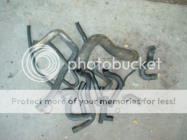

Just for fun, here are most of the fuel, vaccum and coolant hoses and o-rings that were swapped out.

Okay, that helps a lot.  Apparently on my car somebody switched the short heater hose and the long heater hose in the past.  Putting the short heater hose on the T-fitting essentially disabled the aux thermostat, since a thermostatically controlled flow that flows back into the same line has no effect.  It makes much more sense that the small-diameter hose carries that flow into the long heater hose line.
