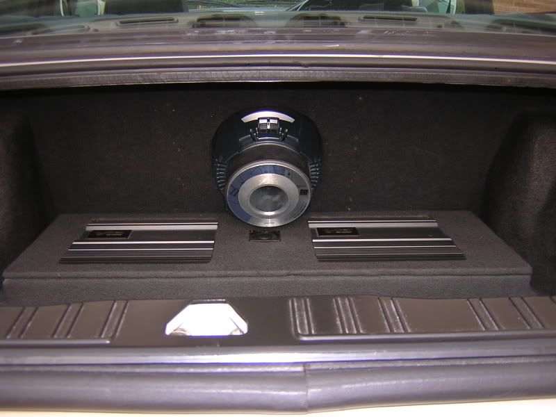

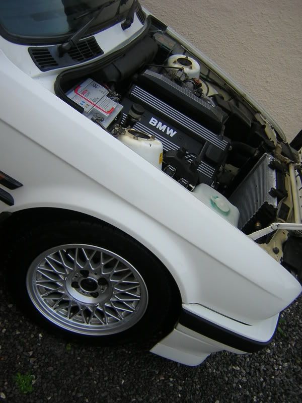

noticed that your battery is up front...did you do that, or thats how you bought the car??
also, i have setup my sub as a free-air as well! i've got 2 amps, one for the sub of course and the other for a set of components. i love the box for the amps..i mounted mine against the back surrounding the sub. i need to get something to cover up the whole mess of wires though. what kind of carpeting did you use to cover up the amps?
