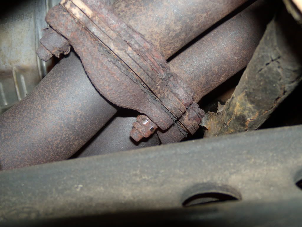

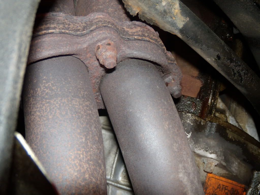

These are the "bolts" that connect the rest of the exhaust to the header, right by the tranny.
I can't remove transmission until I get these fricken things off!

They are welded studs on one side and nuts on the other. You can get new studs and nuts. You might need to put some penetrating oil as with the heat the copper has rusted out somewhat.

Looking at the pics again, looks like the nuts are stripped. So you might have to cut them or use a special tool for stripped items.

Damned drill 'em out of cut them off, aint no other way they're coming off!
And put copper ones on when you do it back up!
