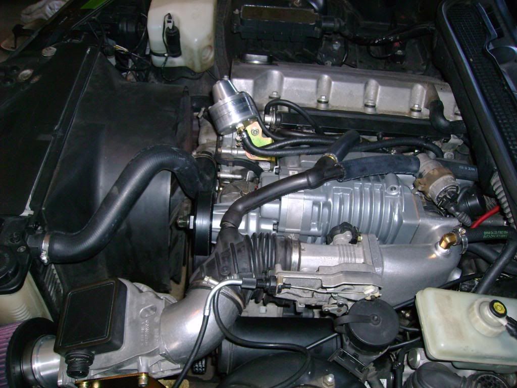

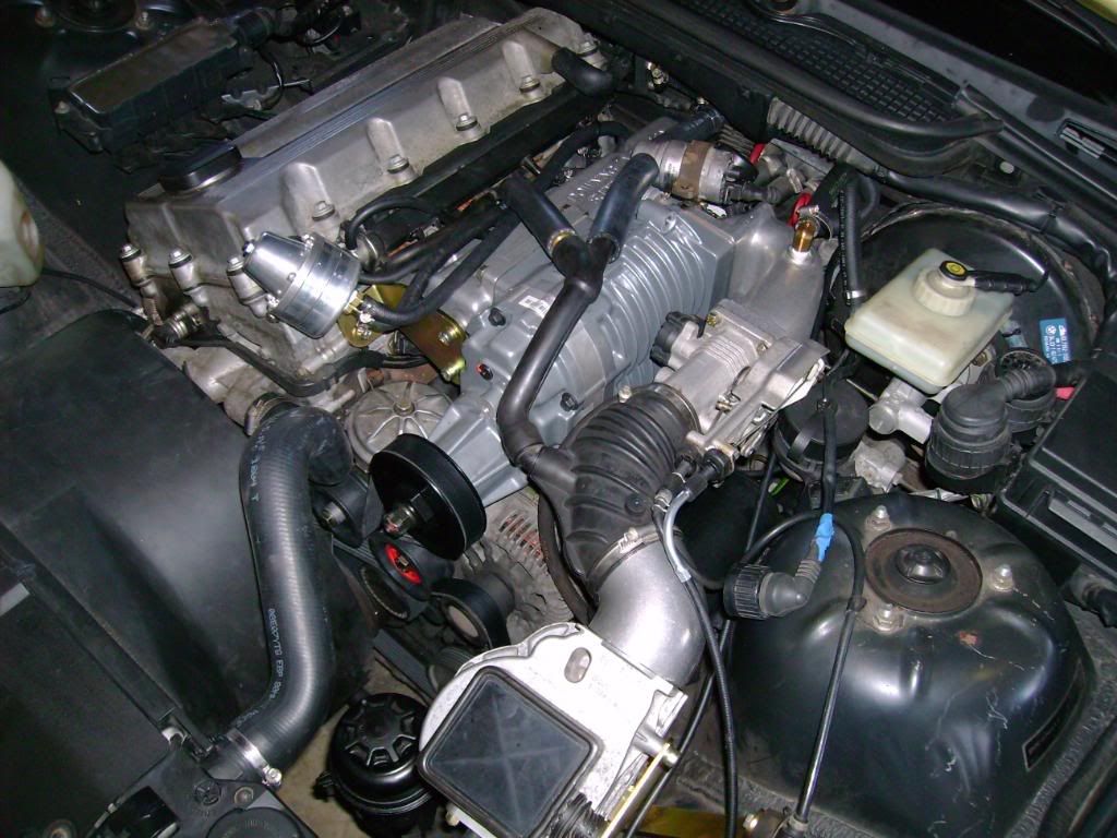

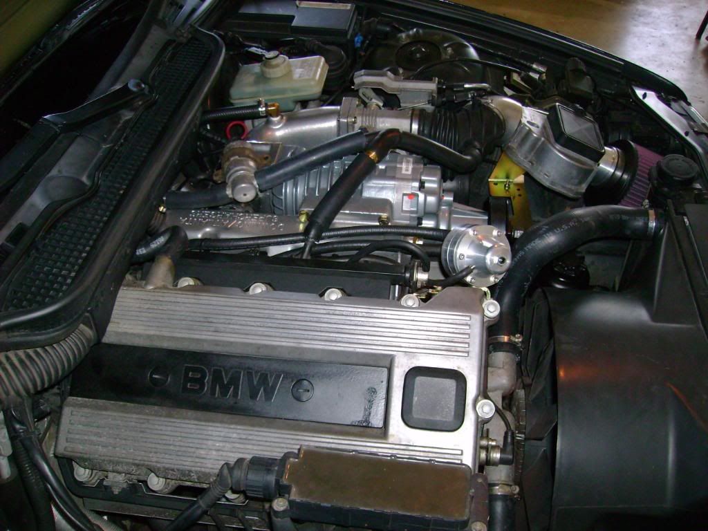

I gotta say fellas, this kit is definitely worth every cent. Everything just goes together so well and all the parts are high quality craftsmanship!
The car drives phenomenally. At about 3200rpm, you start to hear the S/C whine, and by 3500 and all the way to redline the thing screams!
NOTE: the AFM plug had not been spliced and lengthened as of these pictures yet.
Have a video, but the point-and-shoot camera is crap and the video therefore, sucks. Will have to get some better video another time.

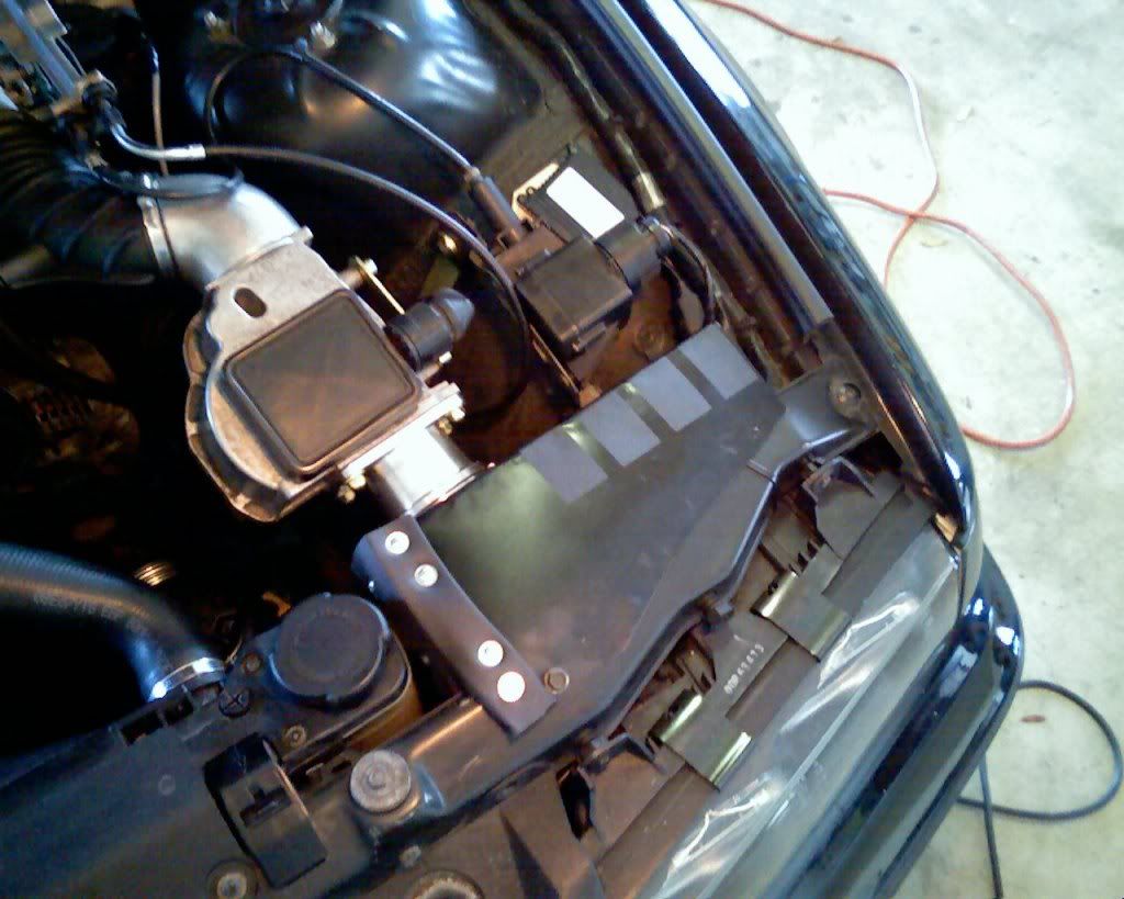

Last weekend, I also make a custom intake heat shield box. Not the prettiest thing in the world, but I think it should definitely help keep some of that heat out, and keep the fresh cool air in.
