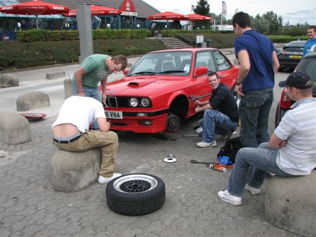

Me trying to fix my caliper while every one watchs and dave with the golf was trying to find the brake hose that had wrapped round the strut.
