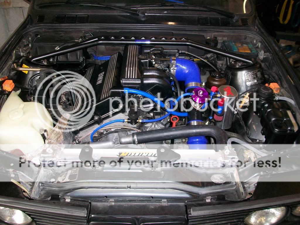

oh ya, and that elbow deal..I was able to cram a 2.5" on the stock AFM but it wasnt easy. 3.0" however is wayy to big so you kinda gotta make the 2,5 work.  just spit on it and use a thin little flathead screwdriver or something to sorta work it on as you push down.  two peaple will make it easier too.
so, the official size to go from the stock AFM to the TB is 3.5" - 2.5".  now the other question at hand is whether to use a 90^ or a 45^ because the angle is somewhere in-between.  I would say its closer to a 90 if anything.  I imagine most of you guys running the stock afm dont still have it mounted in the origional location so that probably doesnt matter anyways.
there is one more issue at hand.  the hose that comes off the factory elbow that goes to the idle control valve will have to be sourced from somewhere else.  you  could use the barbed fitting that the valve cover breather hose goes to and run that to the idle control valve.  that hose needs to get vented to atmosphere anyways to so you  dont boost the crankcase so that shouldn't be a problem anyways.

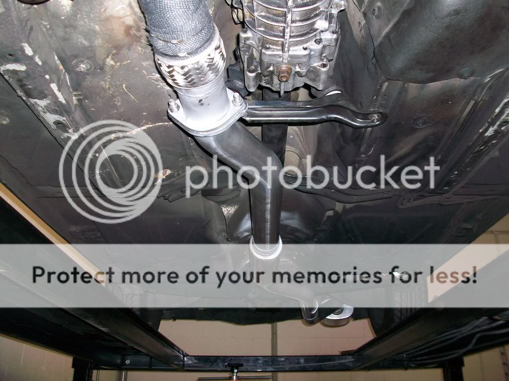

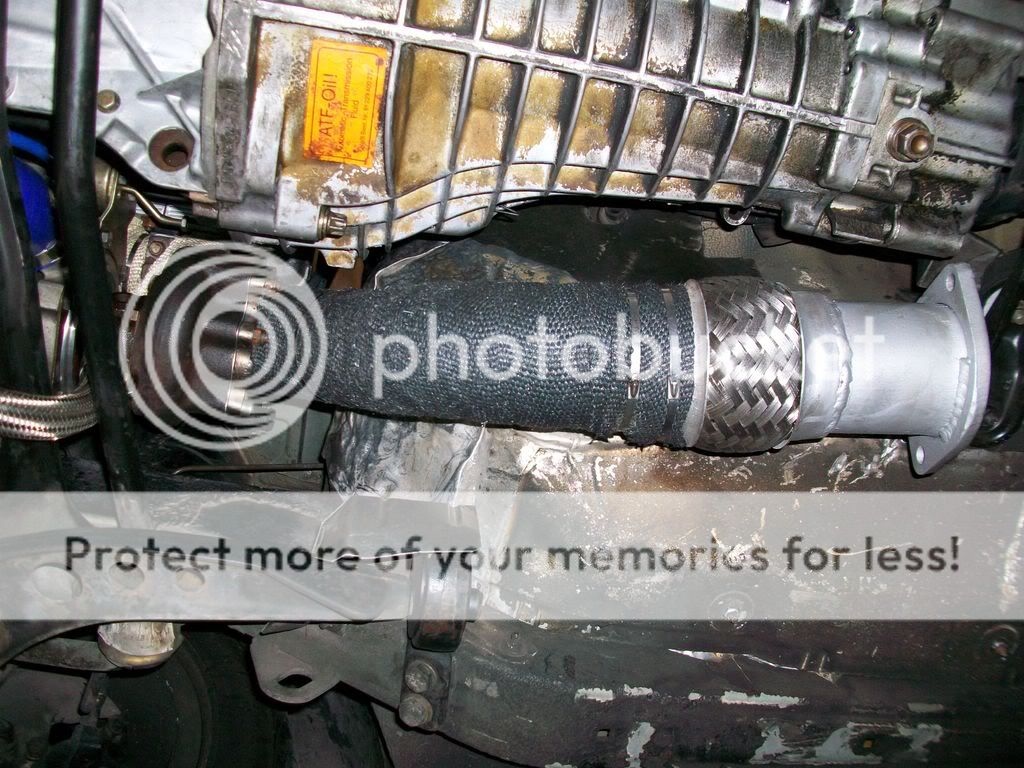

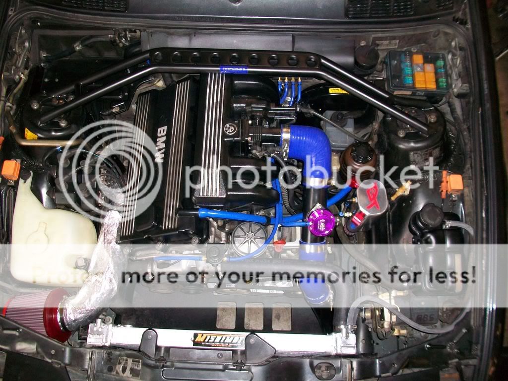

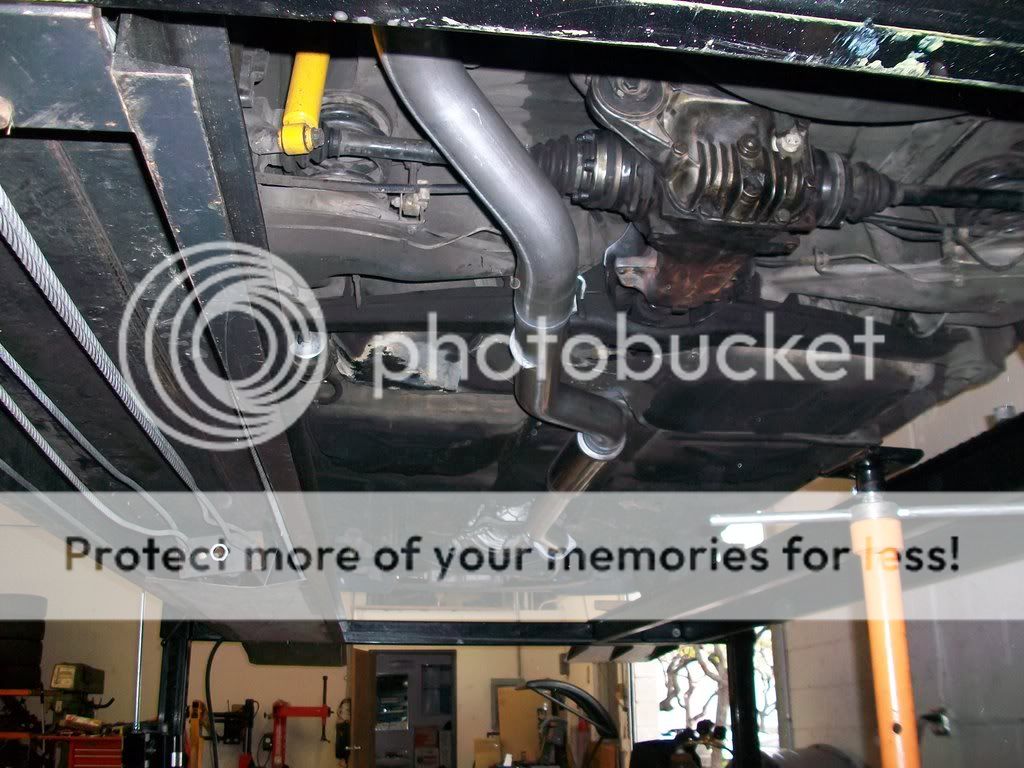

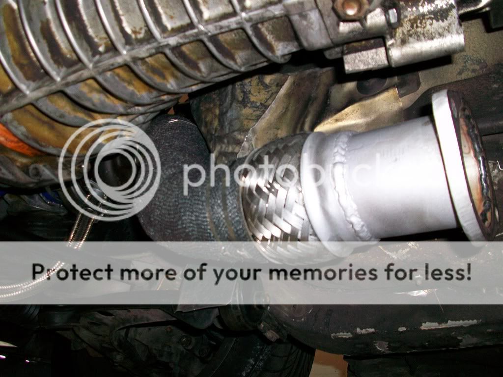

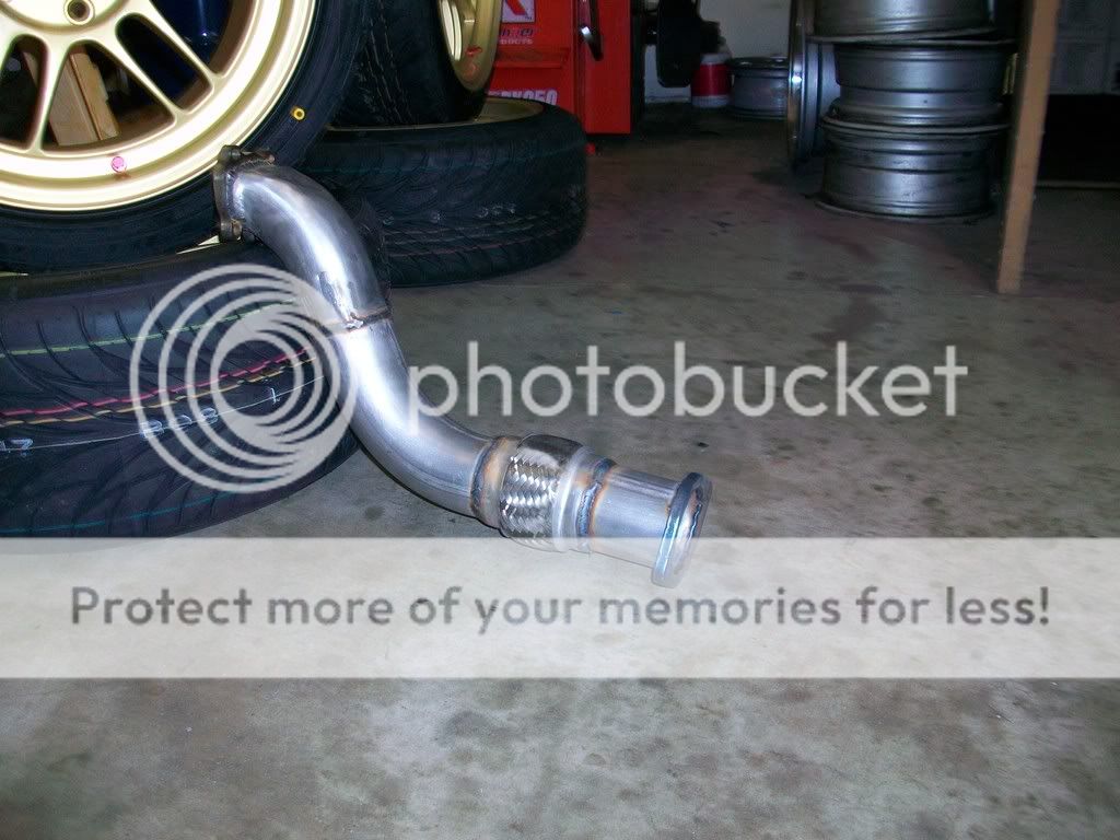

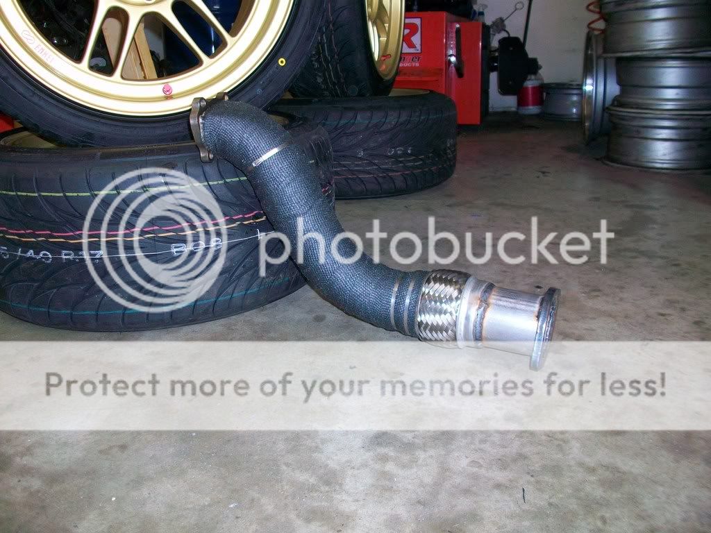

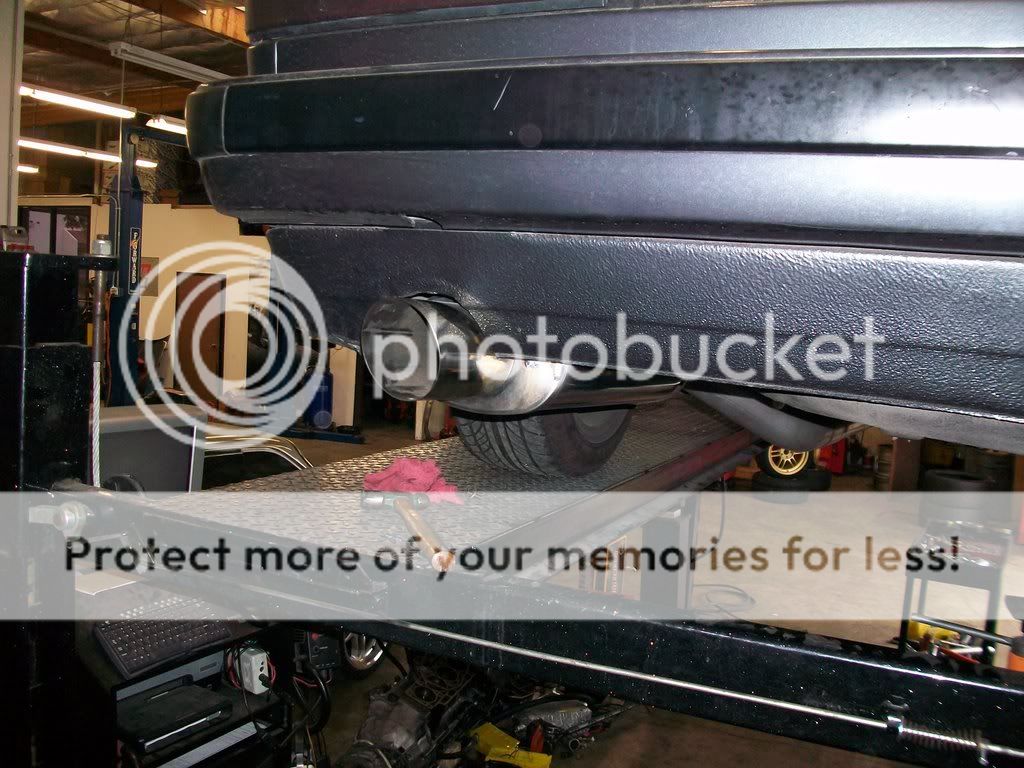

exhaust is done
« Reply #35 on: January 23, 2009, 10:49:59 PM »
got some stuff done.
installed the catch can and m20 coolant expansion tank.  made the down pipe and full exhaust.
just need to build my MSQ file and tune, tune, and tune some more
some new pics
downpipe and exhaust are 3" fully mandrel bent with magnaflow resonator and muffler
noticed what this label on the front core support actually said, thought it was pretty funny
« Last Edit: January 23, 2009, 11:02:08 PM by tglaze »

roundel318
  • Posts: 512
dynotech motorsports budget turbo build
« Reply #36 on: January 24, 2009, 10:09:56 AM »
Nice work, love the OE sticker in the last pic, albiet out of focus....

« Reply #37 on: January 24, 2009, 04:02:52 PM »
nice exhaust how does it sound pretty loud what kinda muffler did you use??
tglaze
  • Posts: 96
    • http://www.dynotechonline.com
« Reply #38 on: January 24, 2009, 05:13:01 PM »
its a magnaflow resonator and muffler.  havnt fired it up yet, still have to build my msq file.  shouldnt be too loud.  i'll post a sound clip when i get it going as well as a dyno video and what not
