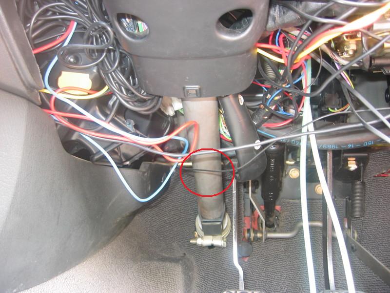

Sorry to be a pain guys but I am unable to upload a photo of the steering column and am still unable to find the big nut if anyone can post a pic of it that would be great everytime Ive tried its failed.

heres a pick of my steering column can someone please point out were the big nut is its making me crazy

  • Posts: 1378
Steering Clunk..???
« Reply #21 on: February 03, 2009, 06:04:49 AM »
Is that a cover on the column?
I'm away from my car until Sunday, or I'd post a pic of mine, but it should be right around where the circle is.
genna
  • Posts: 25
Steering Clunk..???
« Reply #22 on: February 03, 2009, 07:19:56 AM »
yeah its got a cover it thats why I was so curious about where it was

« Reply #23 on: February 03, 2009, 08:54:06 AM »
Quote from: genna;65845
Mine looks exactly like yours and I couldn't find anything in the Bentley or BMW Fans to provide an answer. My car's non-airbag, LHD, ECE. Wonder if the airbag makes the difference?

Airbag and non-airbag does make a difference. They use different columns. Only the airbag ones in the E30 are specifically known for making this noise, although I guess E36s could too.

My 1991 318ic has the thunk/clunk. I read this whole thread but still don't understand what nut to tighten. I will pull my car apart to look myself but it would be nice to see a pic of exactly what I'm looking for.
