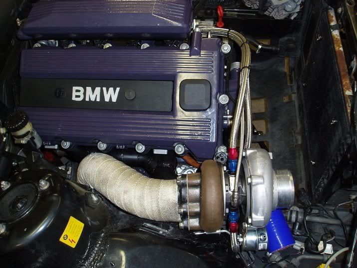

Ive done it with a 3inch dump pipe, it is a very tight fit
