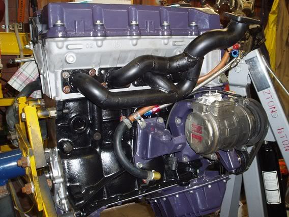

bar73k
  • Posts: 86
M42 Turbo Manifold
« Reply #14 on: June 29, 2006, 02:46:40 AM »
here is my manifold, im keeping the a/c but will be getting a new hose made because the old one is in the way of the manifold.
this is a right hand drive car, and will have a 3 inch dump pipe, things are pretty tight.
