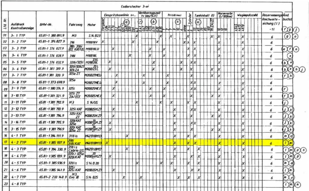

« Reply #24 on: January 15, 2010, 03:14:37 PM »
Did anybody succeed to make copy of the chip?
Man from another forum gave me this:
13 button obc
« Reply #25 on: January 15, 2010, 04:10:42 PM »
That looks promising...I wonder if those are correction factors, and if they relate to memory blocks on the eeprom?
IvanB
  • Posts: 5
13 button obc
« Reply #26 on: January 16, 2010, 04:11:35 AM »
The chip is ROM Its programmed once, and then you cannot reprogram it. Chip number is TBP18SA030EN. I did not find datasheet for it, but found for TBP18SA030N which i hope will work. As i read its 256bits memory, 32 words X 8bits. It has 16 pins. Now its up to someone reads m42 code plug and write it to another chip.
