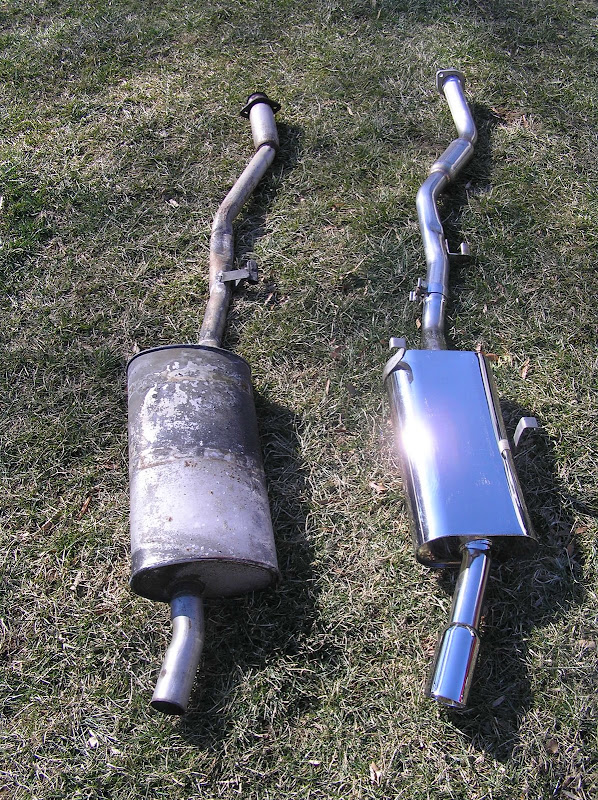

I'm very partial to my Triflo exhaust, but it is quite a bit more expensive than most people are willing to do on these cars.
