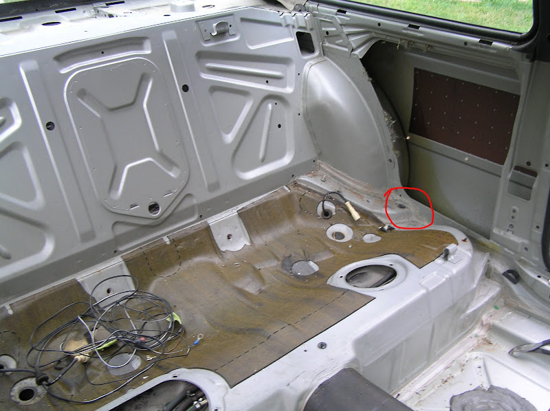

Have you already located the tops of the bolts? They are under the rear seat, right in front of the wheel well. There is some goo in there holding the bolt in place, IIRC I just scooped some of it out but not all - enough so that I could spray PB Blaster down in there and get it to soak through. That is an important step.
Loosen the nuts so they are flush with the end of the bolt, and knock the bolt out by striking upward. You'll probably want to put a towel or something over that hole, to keep the bolt from sailing up into the cab when it does finally break free.

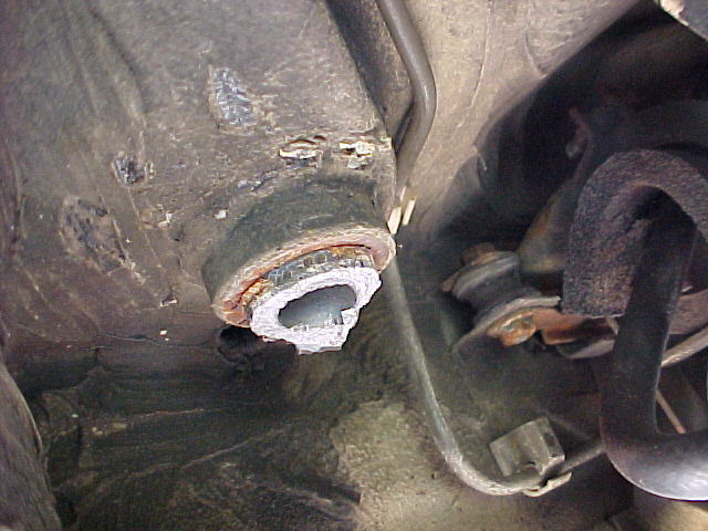

Well, if you got the bolts out, don't worry about loosening the nuts until they are flush - the concern was that you not mushroom the threaded part of the bolt when you were pounding them out with a hammer.
What is probably holding them in is the fact that there does not seem to have been any antisieze put on the metal nipple of the bushing when it was orginally installed in the body of the car. Dissimilar metals, water/salt/time, etc. - the two parts essentially fuse together, making it extremely difficult to remove the old bushing in one piece.
This is a comparison of a full bushing, and what was left when mine came out of the car:
The end that is left in the car has to be removed, and it is a bit of a pain.
I just used a long pry bar on the subframe to essentially snap the end of the bushing off, then Dremeled it out. Unfortunately, there is no access from the top to drive it out, unless you can somehow thread a bolt into the bushing material from the bottom and then smack it out with a drift from the top.

So...John...my situation is identical to your 2nd photo in post #3 above, on both sides :rolleyes: snapped both them suckers right off after torching the crap out of the old bushing material.  If I understand you correctly, you Dremeled those out?  Did you grind them, cut them - how do you avoid excessive removal?

When mine got stuck like the ones in the picture. i used a drill and chisel to get the stuck part out.

I used a cutoff wheel and sliced a chunk out of one side, then a punch to collapse the ring in on itself. Other methods will work - I've heard of folks tapping the hole, driving a bolt in there, then whacking it from the top, but I dunno bout that...

I used an air hammer/chisel and chipped out the remaining metal after cutting off the bushings.  Once I got to this stage it was pretty straight forward except for the abject fear that I would damage the the frame. I went slow and it came out all right.  After cutting the bushing off the clean up (chip out) was only 10-15 minutes.
