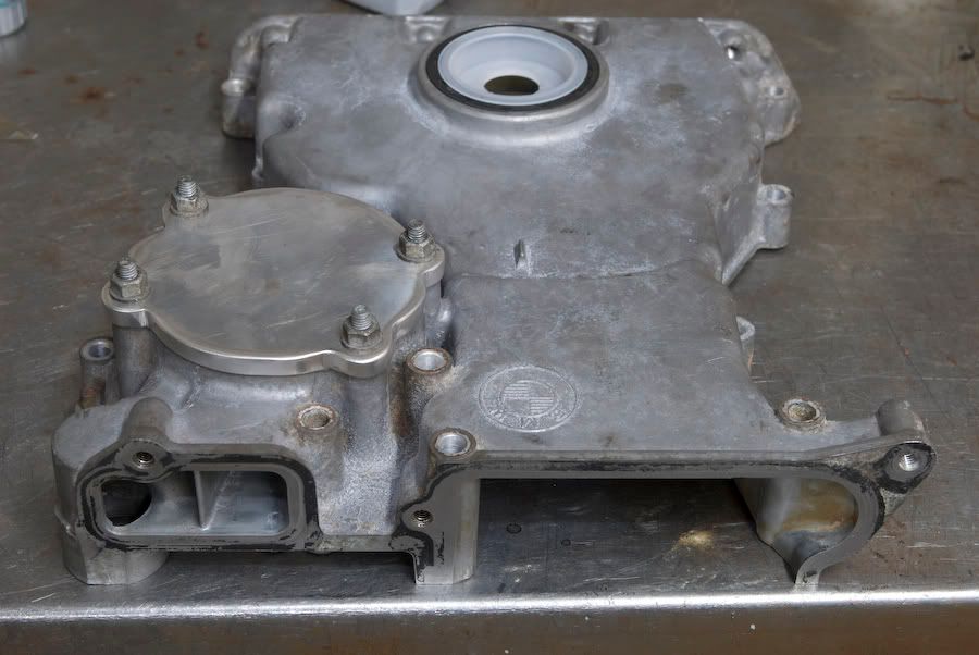

It's a common thing on lower hp race cars with less than 300hp or to use electric water pumps in addition to the belt driven pump for extra cooling.
Here is an example: http://forums.bimmerforums.com/forum/showthread.php?t=961380
Stock pump is removed and replaced with a simple cap:
The electric water pump being used:
Not a very cheap thing to do since that water pump is $420.  Cheaper electric water pumps are around $200-250.
Also you can't forget that the fan mounts to the water pump, so by eliminating the water pump, you also eliminate your ability to use a mechanical fan.
Lastly, by removing the water pump you also remove one of the pulleys so say goodbye to your stock length accessory belt and possibly needing to do something custom for the routing of the belt.
But switching to an electric water pump (and forcibly and electric fan and removing a pulley and water pump) you would definitely lower some engine rotating mass and remove some rotating drag.  So maybe like 2-5 hp and slightly better mileage?

im putting a davies craige unit w/ controller on my m42 as soon
as it arrives. if all would like i will record step by step.
i just did a A/C delete &
after the electric water pump I plan on doing an electric p/s system.
the less the motor has to work against the better it will run.... right!
to be continued ...........

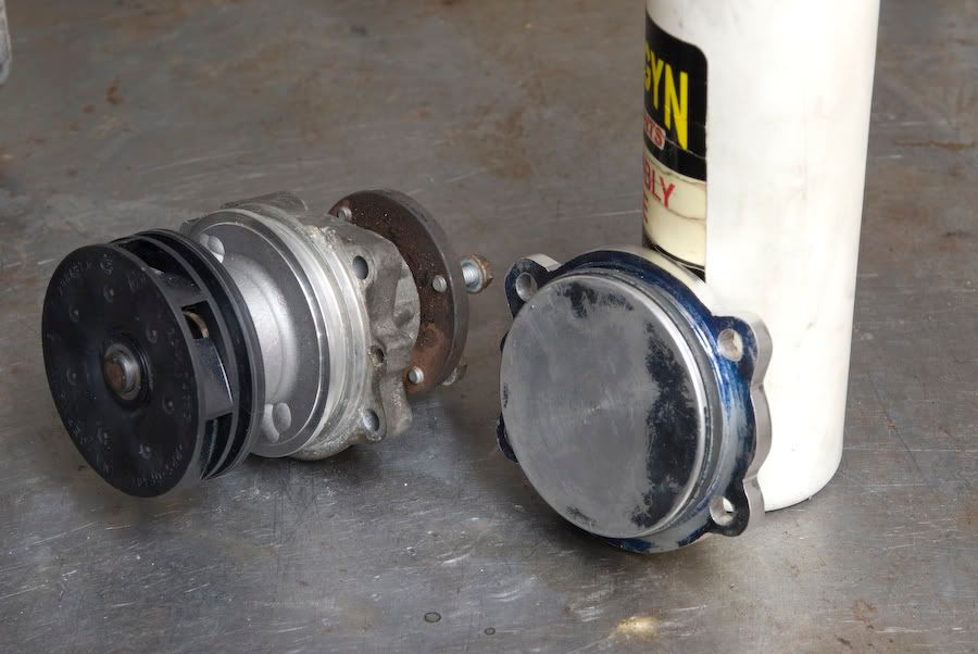

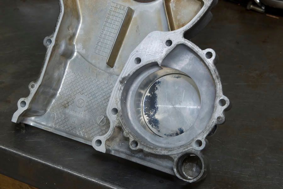

    2- [I gutted my oem water pump, then took the body & cut it down
on both sides the inner and outer part.
                    **do not cut the inner side to close to the o-rigs groove**
I cut mine to my own personal length. (u can cut yours or leave it a lone)
    2a-Then I took a steel washer and welded the hole closed, put it down in to the
 body sitting flat , then filled the body with epoxy (I used HILTI BRAND) let it cure
 put a new o-ring on and install.
