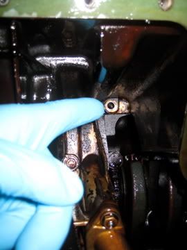

xwill112x
  • Posts: 691
Engine failure due to pan gasket shift/bolt loss (e30 only)
« Reply #102 on: October 29, 2008, 05:04:44 AM »
k
so i first read this..say.. around july?
i was like...ehhh ill get around to it..
well last night after pullin the tensioner...i figured wth i might as well check the oil pan...
so when i pull it and i looked inside my thoughts were WTF! :mad:
heres a pic:cool:
and the other two were turnable by my fingers!:mad:
but i got it all fixed now...air wrench+locktite= not coming loose in the next century.
but i still love the car no doubt, and this forum for all the help...thx guys.
M42 FTW!!!
Ich liebe meinen E30
sheepdog
  • Site Admin
  • Posts: 1272
« Reply #103 on: October 29, 2008, 01:32:10 PM »
Yikes!
That is cutting it too close.
There is a reason this is stickied.
