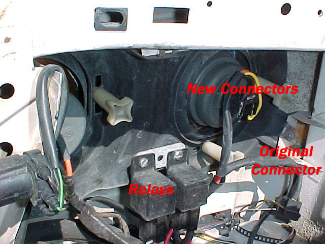

To answer the OP, the connectors for the H1/H4 combo are different than the sealed beam bulbs, presuming that is what you have. As far as changing fuses, I was and remain leery of just changing fuses out without considering the fact that the fuses are sized for the wire that is on their circuit - in other words, a 7.5A fuse is used because the wire won't support much more than 7.5A. If you pull your 7.5A headlight fuses and just slap 15A fuses in to replace them, you run the risk of a lovely fire. It might not happen, but you've just increased the chances that it will.
I ran separate looms and relays, using the original wiring to turn on the relay, and 12ga wire to support the higher wattage bulbs for my H1/H4 lights.

10 amp is all I needed for the fuse upgrade, and the additional load is only on when your high beams are on. I was leary about the wire size as well, so I checked them for heat and found no problems. But I am using standard wattage bulbs. If you go to a higher wattage, then yes you need relays and bigger wire.
