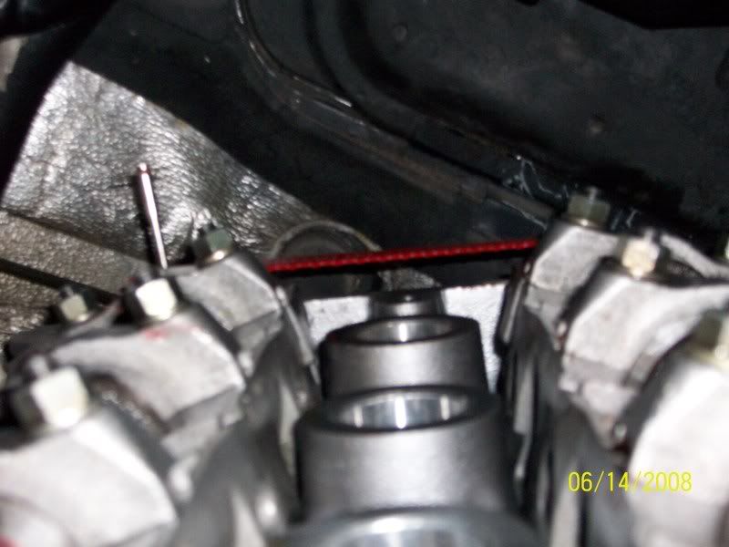

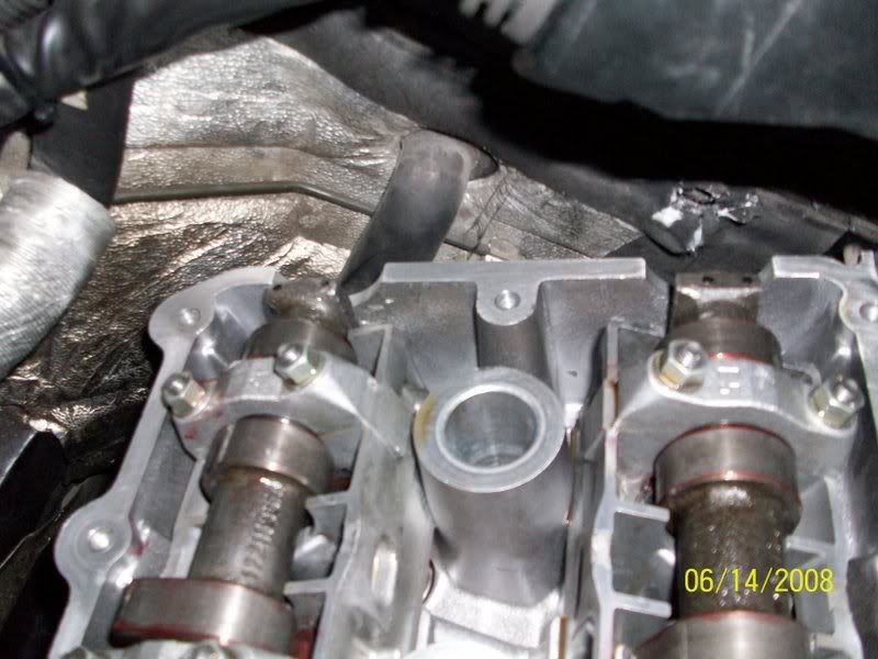

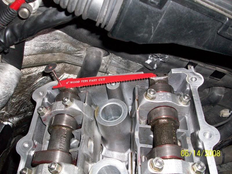

I have put the head on. I tightened all the head bolts down to 22 ft/lbs then an additional 90 deg and then an additional 90 degs. I put a 8mm allen key in the flywheel at tdc. My cam squares int he back are flush with each other, i put a pencil on them and they are flat. I am not sure how they sit in compoarision to the head, But the cams are flat with each other. My sprochet wheels in the front on the cams are 15 links away from each other intermideant.  Now from my understanding this is correct and how it should be?
elementskater_xx
  • Posts: 68
Somethings wrong.
« Reply #38 on: June 13, 2008, 10:27:27 AM »
15 Links apart:
Right timming gear:
Left timming gear:
Cam square lobes flat:
Cam Lobes Flat:
So here is where I am at. Here is where i seem to always fuck it up. So if any one can see soemthing wrong please tell. Me. lso when i turn the crank by hand, i feel some preasure in certain spot when i am turning it.

Use the trick I posted to hold your cams with the rear flats even. In the photo your exhaust cam is off, not flat, it looks a bit anti-clockwise and the intake cam looks a tiny bit clockwise, see how it's not even with the valve cover mounting surface?
All you have to do is take off the cam gear bolts and let them slide off the cams, then realign. I did the same thing you did the first time and puzzled over it, then adjusted it, tried again and it was right.
What is really important is if you have the cams themselves in the right position to begin with: front lobes pointing towards each other
When the cams are in this correct position
and
When the flywheel is at TDC
and
When the flats of the rear lobes are clamped firmly in a perfectly flat position
and
The tensioner is not applying force to the chain
then
The cam gears will go on in a perfect alignment with the cam gear bolts truly centered in the cam gear elliptical holes.
15 rivets inclusive from arrow to arrow is correct, but remember that you may be one tooth off on both cam gears if they are not lined up correctly.

I think you may just need to loosen the cam gear bolts, reposition and lock the cams and you may be good to go.
