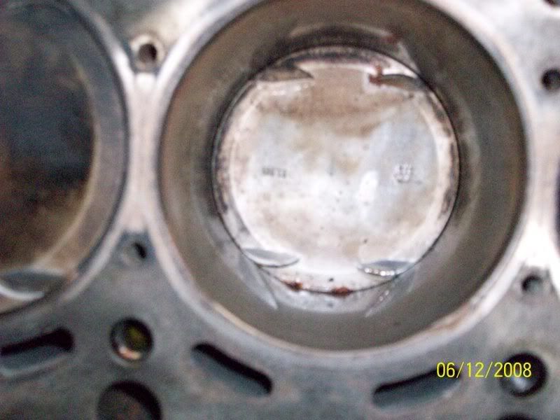

« Reply #21 on: May 13, 2008, 06:57:22 AM »
Ok so i looked at my pistons and my timming was def off. I have stamp markings in my pistons. They are off from the original ones. Like right next to it. I am probably picking up a new block within the next week. But i am not sure. Anything I can do to maybe resurface my pistons without taking my engine out of my car?

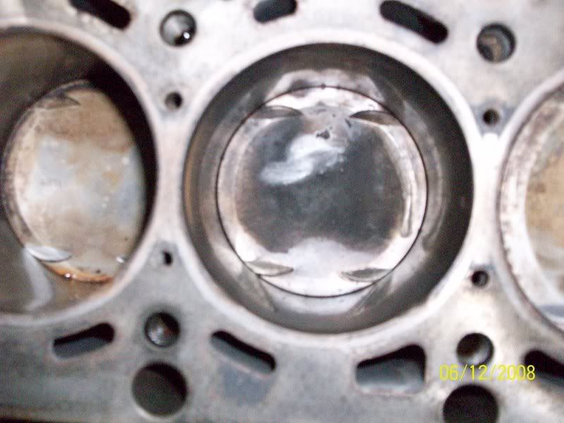

Quote from: elementskater_xx;49207
What do you mean resurface your pistons?
How bad can they be. I am doing a engine build for a guy who bent all 8 exhaust valves. Pistons are fine. Don't get me wrong, they got some dings in them, but nothing major. I have done many a head job with busted belts and chains, never have had to replace a piston. If your pistons are bad enough to need to be resurfaced, (which you can't do) they need to be replaced.
Lets see some pictures of these pistons.
I can't imagine what your old drill sergeant say to you right about now. I can only imagine.

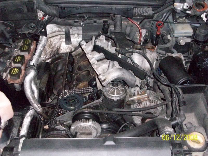

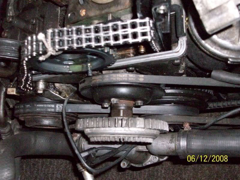

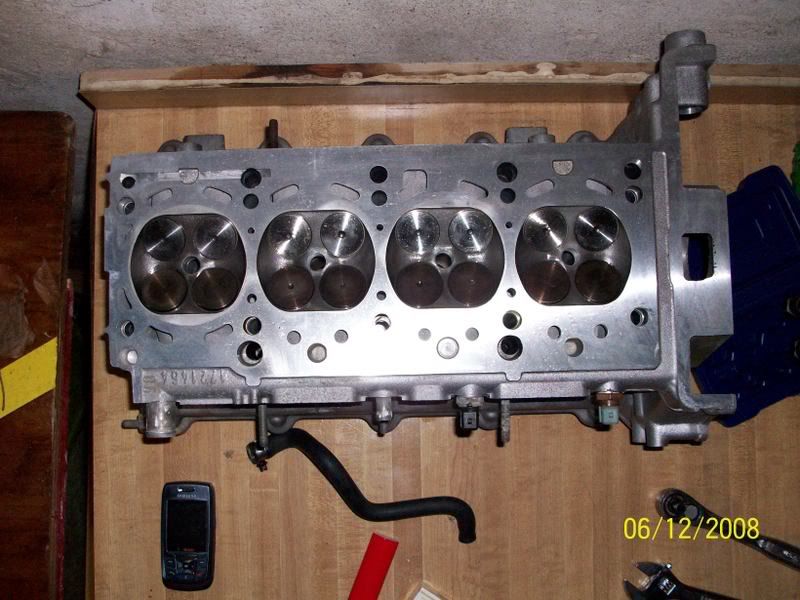

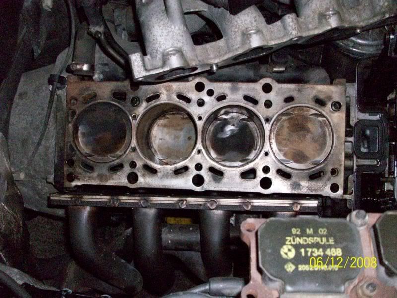

elementskater_xx
  • Posts: 68
Somethings wrong.
« Reply #27 on: June 11, 2008, 11:17:21 AM »
This is where i am at so far. Sorry it took so long had some stuff to finish up. I got my head back again. They said i bent all my exhaust valves. I tried looking for the tool needed to set my cams but can't find it anywhere. Anyone have any advice?
