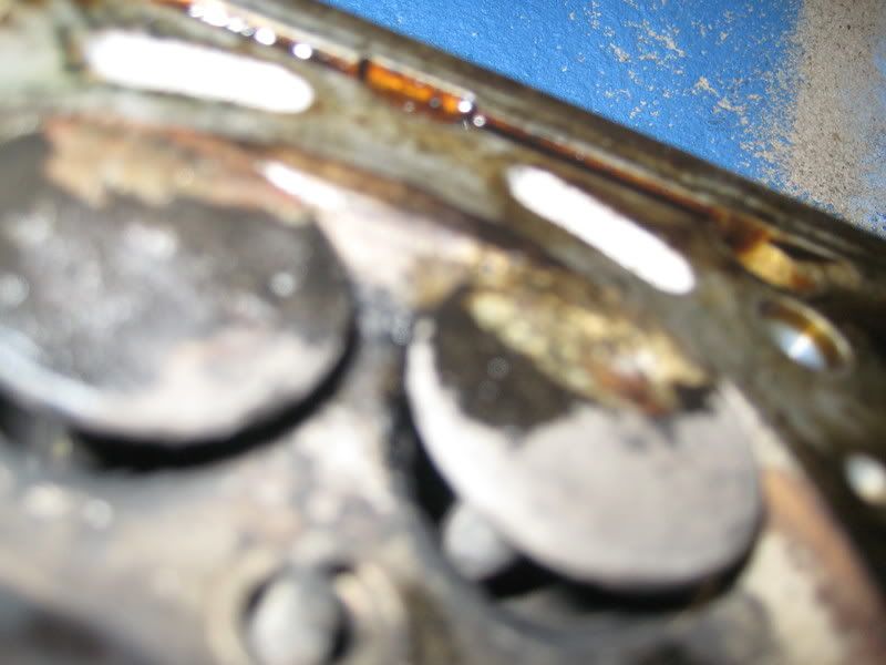

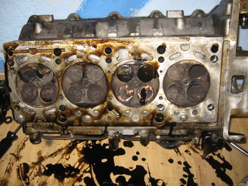

Haha what kind of response are you expecting here?
Get that stuff cleaned up! Have a machine shop disassemble and glass bead the crap out of it :)
Or if you're capable, disassemble yourself and bring the bare head to them for clean up...and while you're at it, get a 3-angle valve job!

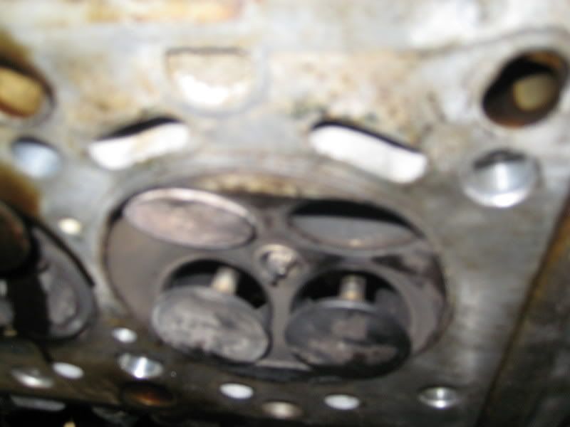

Ok, so head looks like a head to me. Bent valves and all.
For starts put a towel over the head, place a large socket that fits the outer diameter of the valve retainer hat and give it a whack with a mallet. The springs will compress, the keepers pop out and the springs will fly off. The towel over it will keep the parts from putting your eye out and flying all over the shop.
You'll need a good valve spring compressor tool to reinstall the next set. I agree that the best thing for you to do is to take it to a shop and have them hot tank it, or at the minimum parts wash it, remove valves and then resurface the head, regrind the new valves and valve seats, lap them and reinstall everything nice and tidy.
You said you worked in or near a shop so maybe some people can help you with the task?
I spent $70 to have the head resurfaced and cleaned with install/reinstall of all valves (but no re-cutting) included.

well, for one, there is already a MISSING valve in the pics below:
I don't think it was "removed" but possibly made an abrupt exit...

Yeah the valve you see missing was actually removed by me. I can only seem to get one out. I am taking my head to a local machine shop. $400 for a rebuild. I have some pics of the valve that i picked up from nomad and the one i grabbed from my head. My angine def needs some tlc. I will post the valve pics up soon.

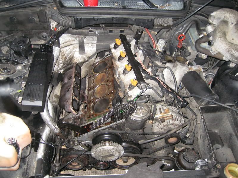

what do the pistons & piston holes look like, any damages to the tops or cylinder walls?

the pistons look ok i guess. I noticed some small burs on piston #1 where the valve clearences are. I am test the integrity of them tonight(hopefully no cracks). The walls look spectacular. I am doing the oil test tonight to see if there are any leaks. Trying to get it ready for tuesday when i start to put this back togethor. I will post some pics of the pistons when i get home.

I wish it was oil...It's carbon.....Yeah it's ok, a tear shed my eye.You can let it out. Remember i bought the car like this. I ran it for maybe 5,000 miles out of the 275,000 it has. And i only paid $400 for it. So it is not that bad. $400 for a machine shop to rebuild it. Getting the 3 way valve job.
