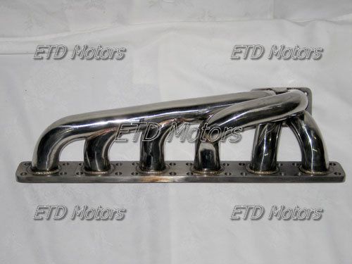

this is my idea of the manifold
my dad works at a shop where they do custom exhaust so the moding on the manifold wont be a problem and im pretty sure it will fit right on as top mount
" ....and the little brown fox jumps over the lazy dog... "[/SIZE]
