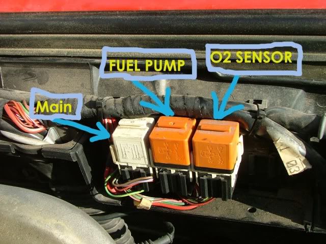

3. The fuel pump works when I jump-wired the #30 and #87 of the fuel pump relay socket. I could hear the sound of fuel being injected into the intake manifold.
4. The fuel pump replay functions well. I tested it with multimeter
