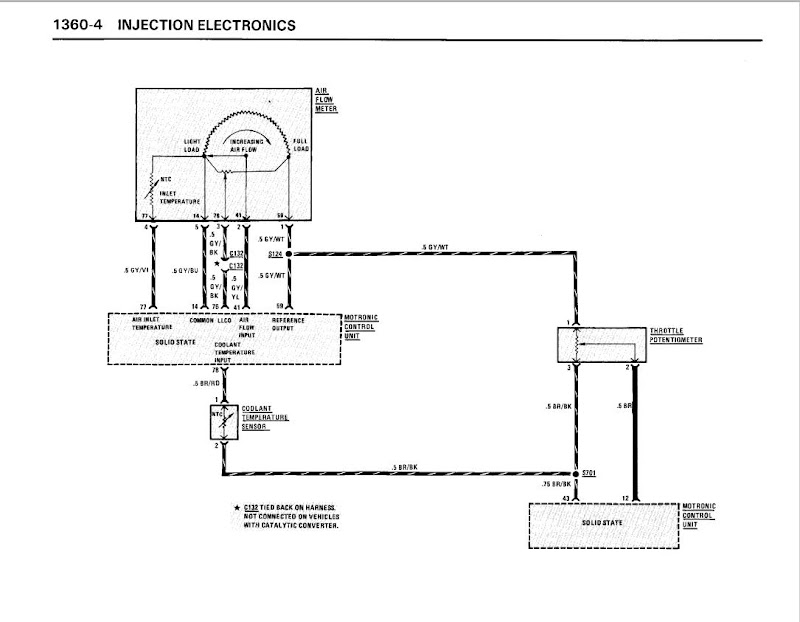

As far as the wiring harnesses, I need a little help.  I got the VW part numbers for all the connector bodies and pins from someone who is no longer an active member here.  It turns out that the terminals that go in the body were not the proper ones.  I got them to work, but I wouldn't sell something like it.  Does anyone know which terminals go with VW connector body 1J0-973-775-A?  Thanks.
The price for the converter and hardware is targeted at $200 (NOT including a MAF sensor). This may change depending on the availability of parts and wiring harness labor costs, but I think it is reasonable.  The MAF sensor is maybe $150 new, and http://www.car-part.com has them for sale anywhere from $50 to $300 used.
I AM working on sourcing an M44 MAF, but finding BMW connector bodies is proving to be a real pain.  That is the big hold-back with the M44 MAF right now.  Anyone have some tips?

« Reply #1 on: April 10, 2008, 11:05:59 PM »
Is this it?
Do you need the part numbers for the pins and sockets or do they come with this stuff?
MAF Conversion V5.2 - Things Are Looking Up!
« Reply #2 on: April 10, 2008, 11:46:07 PM »
The connectors come as the outer plastic housing, metal crimp-terminals, and some thing labeled as a seal which I found has nothing to do with it (looks like the 90degree thing in the first pic and has a mostly identical PN).  The body in the 2nd pic is the one the MAF uses, and I am looking for the terminal PN's.  The ones I was told to use were N-906-845-05 and didn't seem to fit properly (although I got them to work).
Is the car you took pics from a 2001+ VW/Audi with the 1.8L motor?
