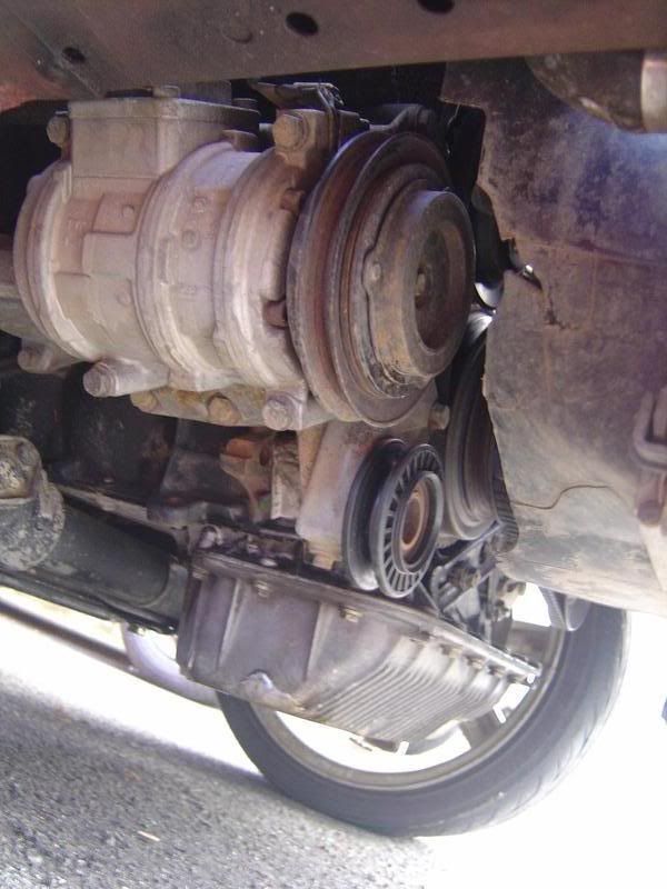

Does anyone have any pictures or diagrams of how the belts should be positioned on the m42? I purchased a new car and looking at the engine today I noticed that I had no aircon belt attached, I want to do it but I am not 100% sure on where to run it. I can guess by looking at my pictures here, but it would be a massive help if I had a diagram to follow.

its super simple with V belts, the belt goes around the a/c pulley, one side goes under that black tensioner which is driven up or down by the allen head visible in your picture.  it goes behind the other belt, so you'll have to remove your other belt to fish it onto the drive pulley.
no garauntee that your ac will work with the belt installed

Oh I forgot to reply to this thread and say that I worked it out after an hour of playing around with it. Got it all connected and adjusted - but the AC compressor needs to be overhauled.
Thanks anyway all.
