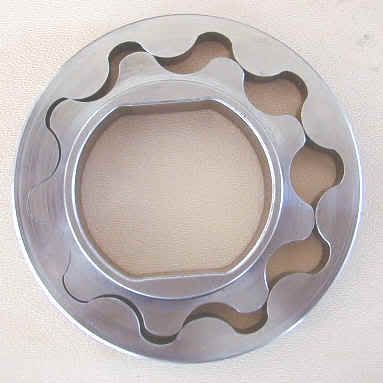

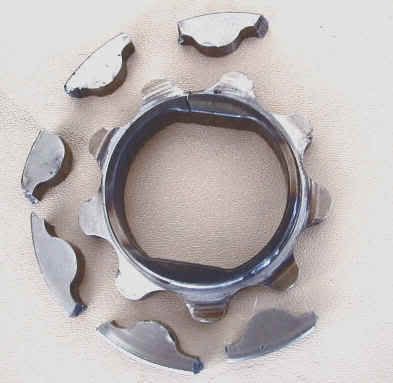

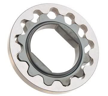

we all know that the oil-pump on a m42 engine is not the best one... is there any possibility to upgrade..?? better flow... etc... maybe the pump out of an other engine?? please dont tell me "drysump blabla ..."  ;-)
did you have any failure with the stock pump?? post pics...
i want to know anything BEFORE i begin to rebuild my engine..

i heared about problems with highreving engines.  Under long high-RPM runs the stock oilpump-gears spin so fast that the gears expands, which destroy the oilpump and if the pump is spinning too fast it cant transport the oil anymore... its called cavitation

i'd imagine that the conditions for that broken set rotor were an extreme incident with a ridiculous amount of heat and friction (nowhere near what i think the average driver would put on their M42). I can also see how addressing problems before these babies become classic, and the years afterward, cause i'm not getting rid of mine. But, that's all beside my point, and i don't know the inner workings of the pump enough to give you an answer, external mounting sounds like an idea.....

The pics above of the oil pump gears - there are two different sets of gears pictured, is one set a revised set?
I understand wanting to protect the engine or upgrading the oil pump, but it seems many folks hardly ever have issues with the oil pump (unless the car/engine was abused or had a lack of maintenance), especially a daily driver.  The busted gears above had to have occured under EXTREME and constant RPM & MPH...

Quote from: Cobra Jet;45050
The pics above of the oil pump gears - there are two different sets of gears pictured, is one set a revised set?.......The busted gears above had to have occured under EXTREME and constant RPM & MPH...
the pics are only examples of different cars...
yes, i am speaking of extended high rpm runs...!! ever driven in the swiss mountains? 20 to 30min full throttle to the top ... and then a small beer! ;-)
