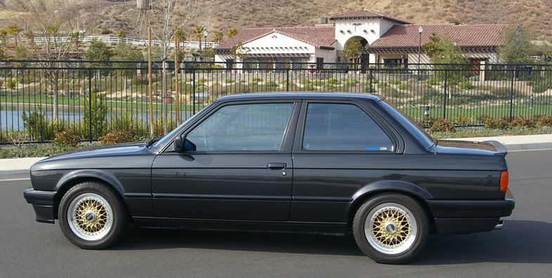

I've got 50404.55's paired with bilstien heavy duty's on my car, take a look

I like the way Eurospec's car looks, so I decided to pick up some HR OE springs and Bilstein HDs.
