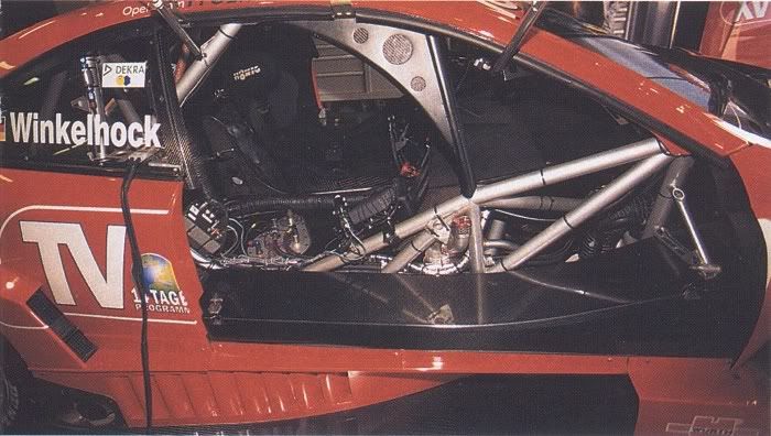

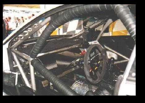

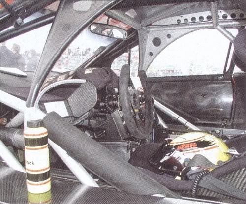

« Reply #19 on: January 27, 2008, 11:15:47 AM »
pics of an older opel astra
the seat is near the rear axle
puuu...! what a sick idea to build an extreme racecar! ;-)
