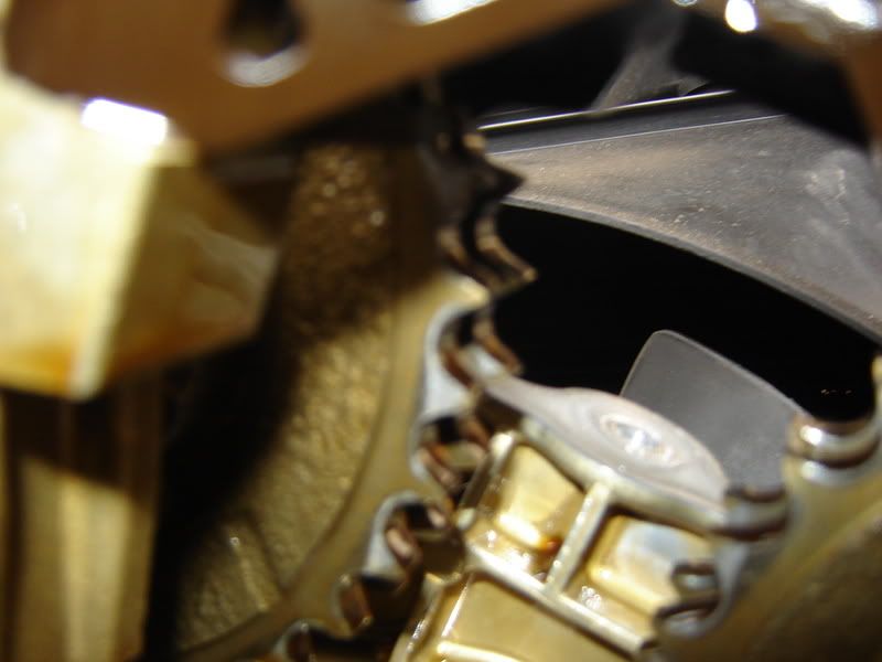

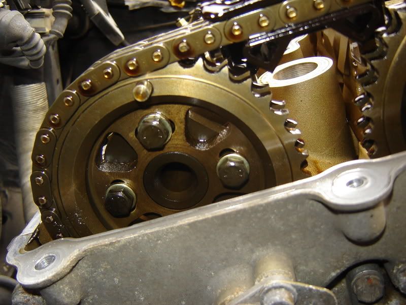

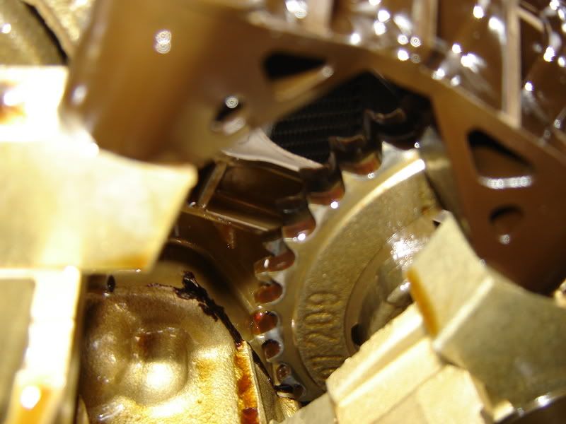

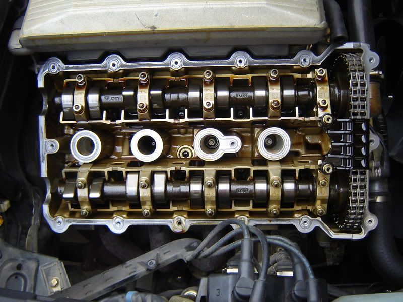

Are my cam sprockets worn...I'm thinking yes
« on: January 13, 2008, 01:45:24 PM »
Okay so I remove my valve cover to take a look at the timing chain sprockets. Based on what I've seen here these look pretty worn (pointed). My gut is that the tensioner has never been replaced on this engine (120K). What do you guys think?
The head does look pretty clean without any sludge.
Thanks for your help!
Pete

Those don't look good . If you look at the tensioner you should see if it's the original.Check this out.

Looks about right to me.
Mine was similar.
If you intend to leave it a bit, make damn sure the pan bolts are in place and that the pickup screen is intact. Odds are you are breaking rollers on your chain.
Just doing the tensioner at this point may do more harm than good.
Also, you may or may not need to replace the guides. Mine were in great shape.
