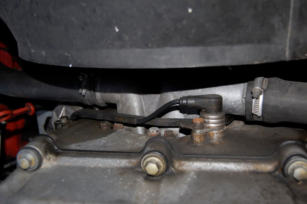

there is a major leak somewhere. its pissing coolant. i have changed the thermostat, water pump and fan clutch before winter and ever since the entluftung screw is messed up. so now it smells like coolant and my straps and making funky noises when cold.

wow, you've got a bit of work ahead of you. Coolant is a pain on these cars just because there are so many hoses. Chanses are your leak is starting somewhere under the intake manifold.

thanks i'll check under the intake in the morning
here's a picture of my leak
