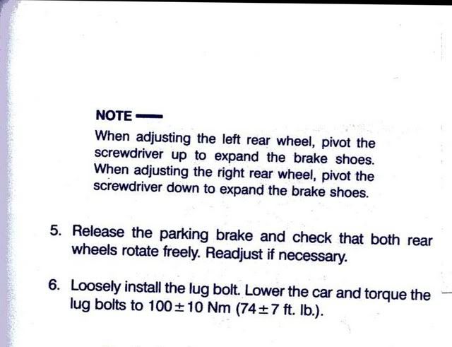

« Reply #8 on: December 14, 2007, 06:39:36 PM »
Hope this helps ,aye
RED IS 91
  • Posts: 981
emergency/hand brake
« Reply #9 on: December 14, 2007, 06:42:00 PM »
I had the same problem .I did this about a month ago .very simple .
The hardest part is finding the star bolt through the bolt hole .

« Reply #11 on: December 16, 2007, 11:46:04 PM »
Quote from: RED IS 91;39475
So I took a look at it this weekend and the font those instructions are pretty small. I have 4-wheel disc. Is there much of a difference in the instructions from the rear wheel drums?
« Reply #12 on: December 17, 2007, 04:22:13 PM »
The car in the article is also 4-wheel-disc. The drums are actually within the brake disc hub, and press on that inside surface. This is why rear brake discs are a lot deeper than fronts.

« Reply #13 on: December 19, 2007, 09:03:04 PM »
alright, for starters the hand brake is only supposed to have 8 clicks max. and mine went to 18(big problem)so I went on a search for this adjuster, so i put the rear on jacks and loosened the adjustment bolts on the inside by the e-brake handle. Then, 2hrs later i found it, not even knowing how many times i was missing it. I was pretty upset because once i found it, it was dark and really cold outside and i was basically turning into ice. So, i will finish that project in a couple of days and thanks for everyones help. If I had a camera I would post pictures, not that it makes a difference because every time i try to post pics they always fail:(
« Reply #14 on: December 20, 2007, 08:03:11 AM »
When I did mine I used a flashlight to see where the star was and then inserted my screwdriver to adjust .
