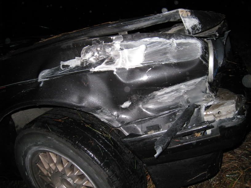

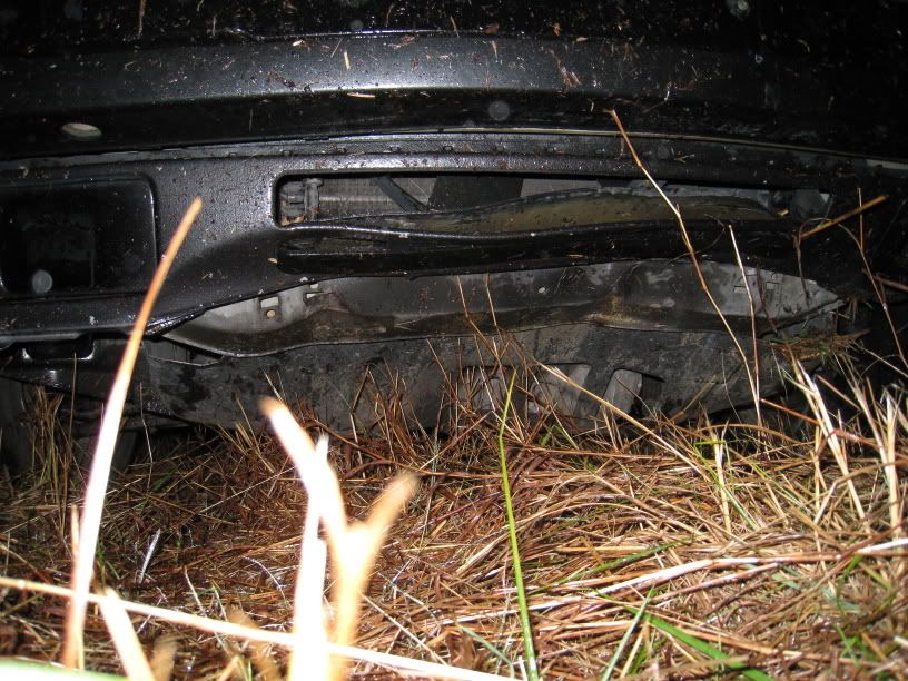

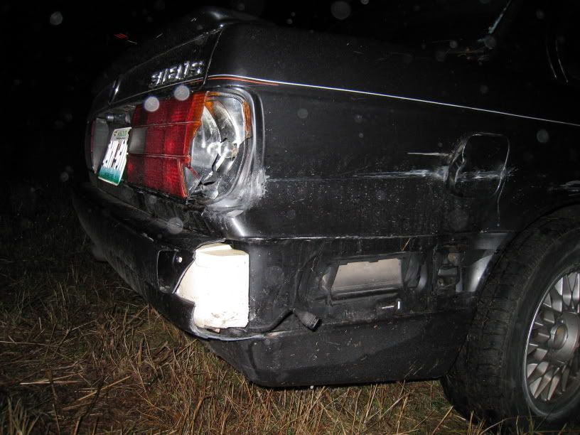

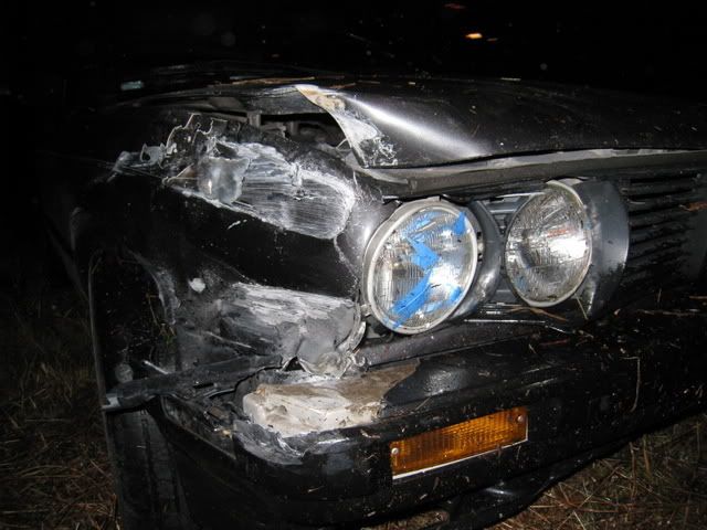

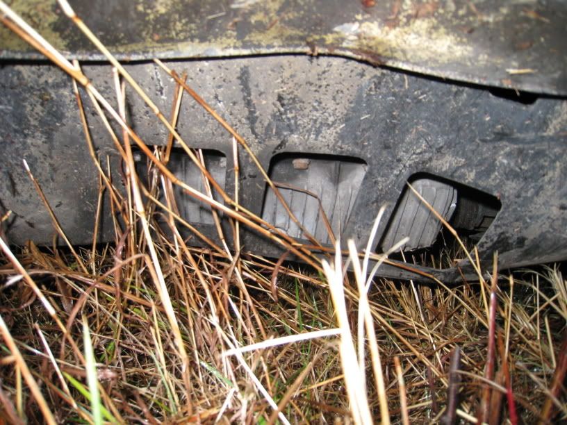

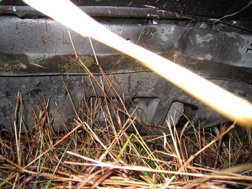

I only took six crappy pics with my point and shoot last night.
I'm going back to where I wrecked when the ice and rain
lets up to take pictures of where I flew off and the guard rail
to show how lucky the car and I really am.
Also my windshield spidered.
but here.
Febi I know I'm more than happy to walk away unscratched. I had my seatbelt thankfully. Its just I loved this car. needed very little tlc to be flawless and on top of all my court dates and tickets why does this have to happen now. Thats kinda whats stuck in my head. This is a horrible month and its supposed to be happy times.

« Reply #6 on: December 09, 2007, 02:32:14 PM »
Fixable.
Alright there is quite alot of bent metal but it's all fixable.
From what I can see:
You'll need a new bonnt, wing, front and rear bumpers, front panel, under tray, rear light, petrol filler cap and the rhs griller section and a passenger side light since the holder is probably broken.
You'd pick up all those parts easy enough second hand.
Then abit of filler to smooth out the scratches on the 1/4 panel
Since it's black, you'll get away with just spraying the bonnet and the right hand side since the colour change wouldnt show up that easy.
You actually got off very lightly to be honest if you hit a barrire at over 50mph.
Very lucky you didn't roll it on the way down or get hurt in the crash.
Bad luck always seems to come in bulk:(
The number of crashes I've heard of people having in E30s now and just coming out of them with no injuries apart from emotional scars and pride destroyed is un-canny.
From hitting poles up to 80mph and spinning around the road and in one case an iS that cleared a fence upside down before rolling 4 or 4 times after being pulled into a bank after a blow-out:eek:
Really bad idle and vibrations is probably because the engine could be after breaking an engine mount or the fan could be catching on the fan surround

Did the oilpan make it? I don't see oil traces.
