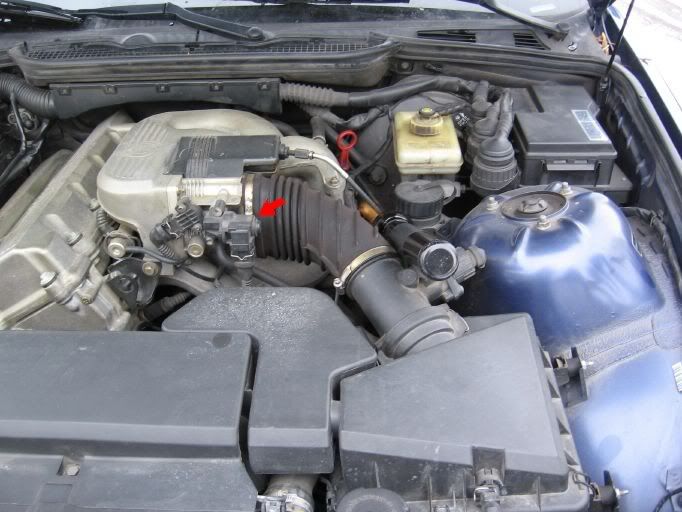

The M44 is pretty different. Plastic thermo housing on the front of the head, MAF etc are the main visible giveaways. the one in the pic above is 100% m44. got any pics of the one you're looking at? as you suggest, plastic oil filter housing can make its way onto both engines, is actually the standard replacement part for all m42s now.

i have no pic of the engine yet (its in the garage) but u mention there a MAF, on the engine i was looking at there was an AFM - flap door, same trick as in old M42 or in my current M40.
is it certain that the M44 uses MAF (niddle type?) - ok, i can answer myself about this -
the engine i bought had metal thermo. housing :
and had an AFM (flap type) the M44 has a MAF (niddle type) as can be seen in the pictures i attached :
Ron.

AFM =M42, 100%

The location of the cylinder head cover breather pipe may help. Early M42 engines had this at the front of the cylinder head cover, adjacent to the oil filler cap. Later M42 engines (1994 on), and M44 engines has it at the rear of the cylinder head cover. If it is at the front then it is an M42 for sure, if it's at the back it could be either.
M44 engines also had the tidy plastic squarish-shaped covers for the air filter, radiator fan shroud, etc that all join together. M42 engines had the rounded fan shroud and a separate air filter housing.
If it doesn't have a MAF then it won't be a M44.
