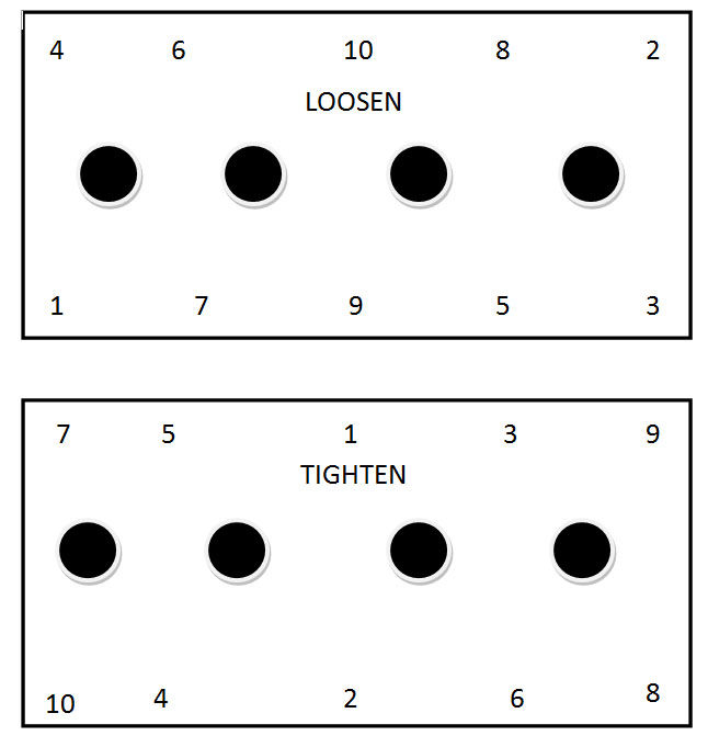

hey guys, trying to locate this. I keep clicking the link but nothing is coming up.

It's on page 113-6 of the E36 Bentley.

OK, page wouldn't scan well, so here is a graphic representation:
Tighten in 3 stages:
Stage 1: 22 ft-lb
Stage 2: +90 degrees
Stage 3: +90 degrees
