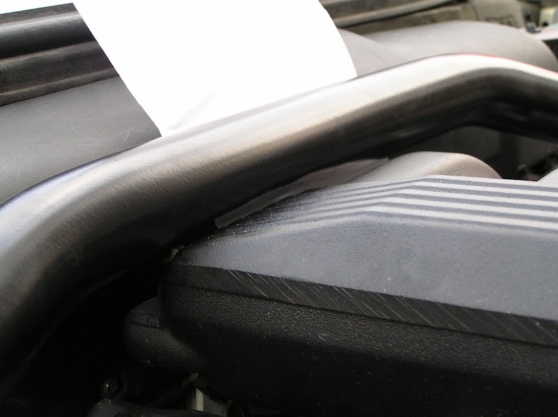

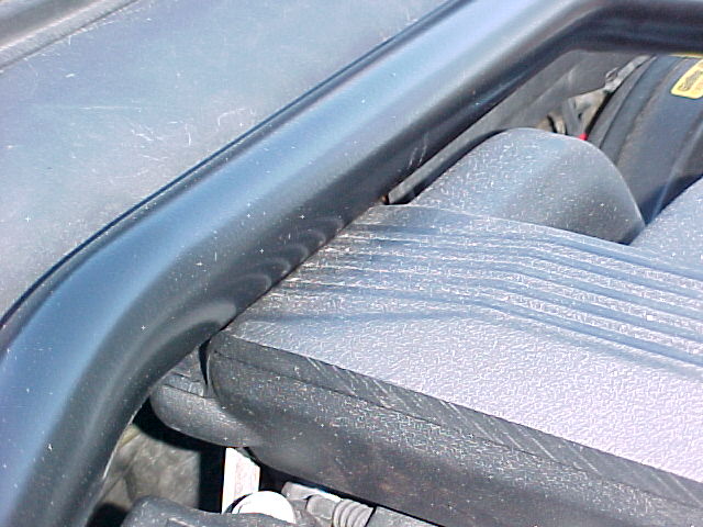

OK, some pics to enlighten those with limited imagination.  :p
Before, when it was hard to slide a piece of paper between the bar and the manifold:
After:
I stuck a piece of paper behind so it would more clearly show the difference.
