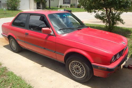

So the rear end is a bit noisy, the blower doesn't work, the drivers side rear wheel only has two bolts in one bolt is broken off in and the other is stripped out, the brakes are sketchy and I think the lines are clogged because I tried to bleed them to nearly no avail, and it has 220k miles.

Noisy rear end: Check diff fluid. If anything at all, could be a diff with low fluid, a f'd up diff or your wheel bearings are on the way out. Lack of enough lug bolts can cause the wheel to be crooked on the hub and mess itup.
Blower motor: There are a few fixes for this. Does it now work at all or it only works on high speeds?
Sketchy brakes: Could be a bad ABS hydro unit, crushed lines, faulty master cylinder.

As far as the lug bolt problems:  The stripped one will need to be tapped out and the threads repaired; the broken off one will have to be drilled out.  Penetrating oil with some large hammer whacking may help.
