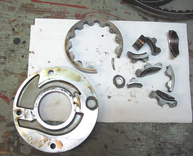

What is that a picture of? Is that damage to a diff?
The noise didn't seem to change with turning. My buddy who picked up the car for me said it didn't sound like it. I'm going to change the fluid back there and maybe that would help.
Anyone see problems with Valvoline 75W90 synthetic?
Alpine003
  • Posts: 848
Bolts in Oil Pan
« Reply #7 on: July 03, 2007, 12:32:45 PM »
Quote from: 91318isguy;29010
The pic is a busted oil pump gear from debris getting into it from the oil pump inlet I'm assuming.

Quote from: Alpine003;29012
Yep, timing housing and pump assembly.
Funny, look at the bottom ad in the middle, "Donate you car".
I almost did after this happened to me. It is quite a time consuming and expensive repair.
10 minutes of work saves so much money and so many hours of frustration.
I think BMWman91 got out of this sort of disaster the cheapest at a few hundred bucks. Mine ran me around $400 or $500. That was doing it ourselves and using used parts and help from the community. To pay a shop to do the repair would probably run around $2000 at the moment. Over half is parts alone.
Shot of my pump, desintegrated at 6k. My timing housing made Bmwman91's look good.
