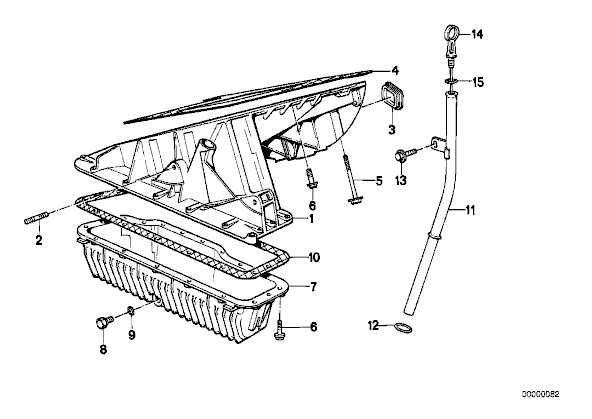

The very first thing I would do is clean it. You can't tell where the leak is coming from when the whole thing is caked in goo.
Then, check again after a fair-to-middlin' length drive. I would bet a donut that the diff is not in fact leaking - that looks like oil that has migrated down from an engine leak to me.
It may be leaking, but there's just too much junk on there to tell where.
