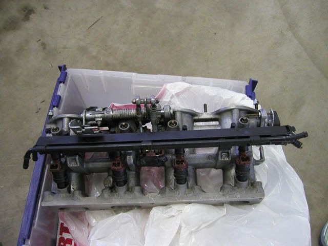

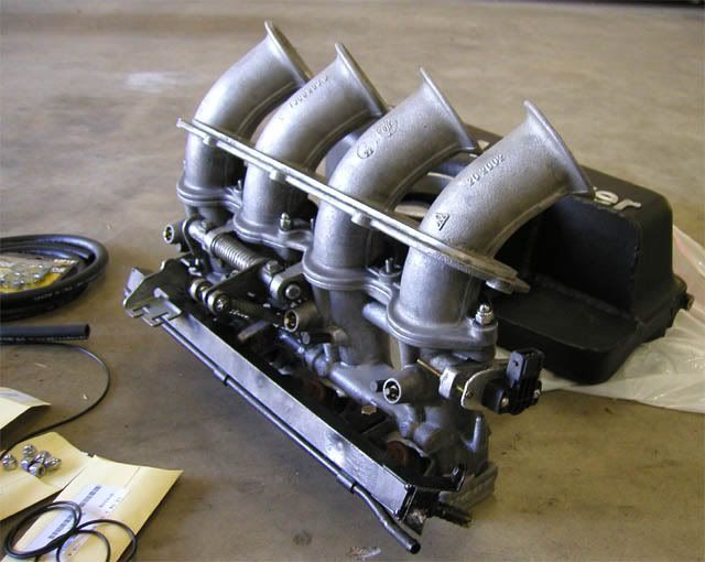

S14 throttles converted to m42, old pics i have from some one who did it!
