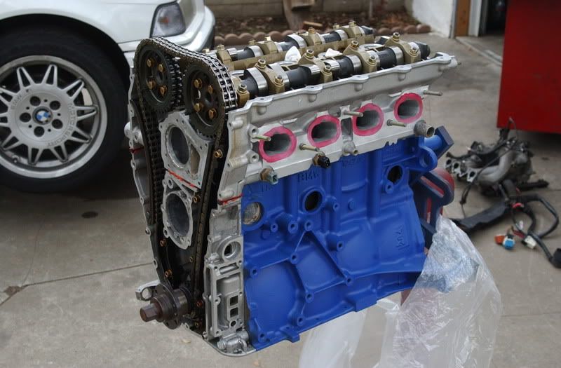

Hello I have built m42 but it is lacking tuning, is anyone running megasquirt in their m42? Is there any difficulty with MS in their m42? All info is welcome

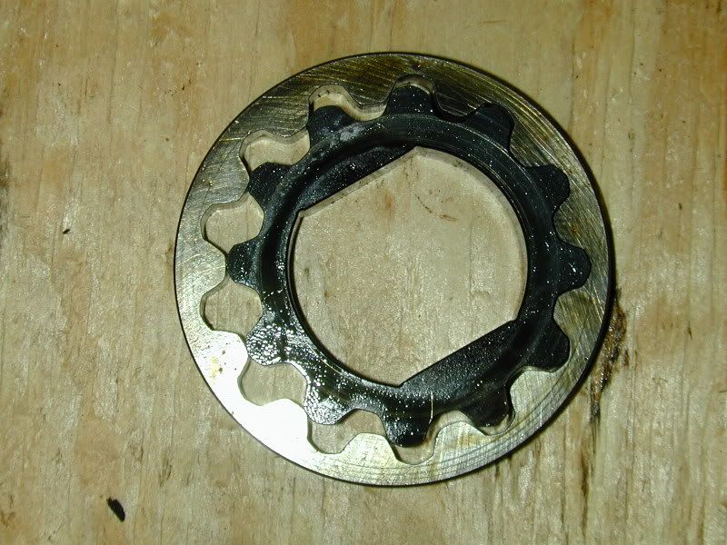

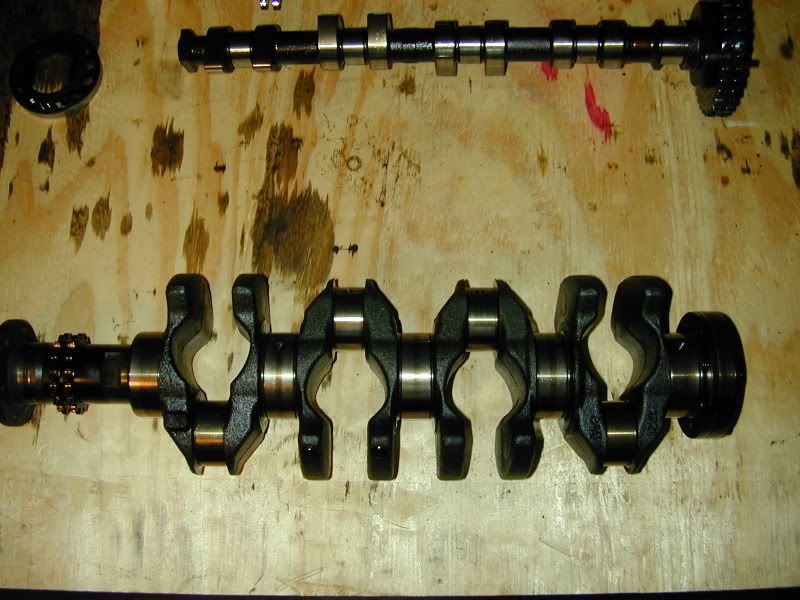

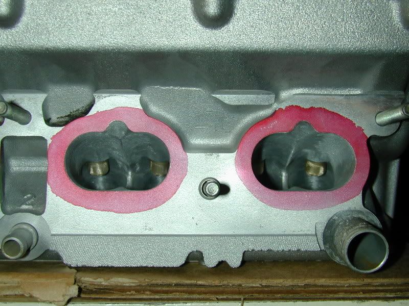

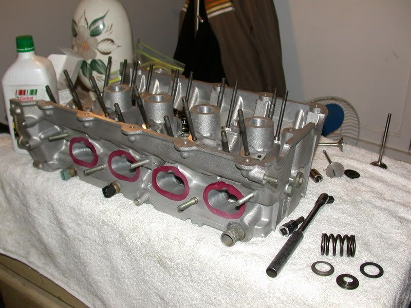

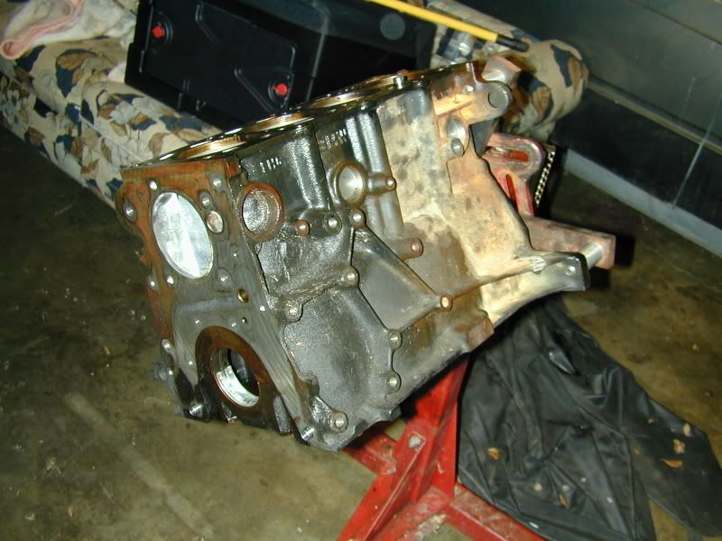

The build
THE CAR
THE NEW
E35 M5 VALVE SPRINGS VS M42
VAC MTRSPRTS RETAINERS
CUSTOM VALVE DEPRESSOR
THE OLD
SCHRICK VS STOCK
GETTING ASSEMBLED
IN THE CAR

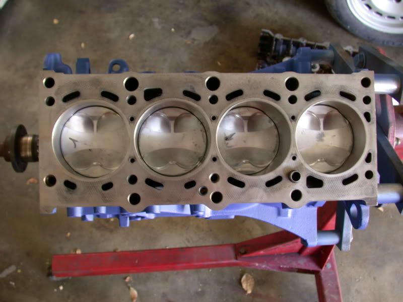

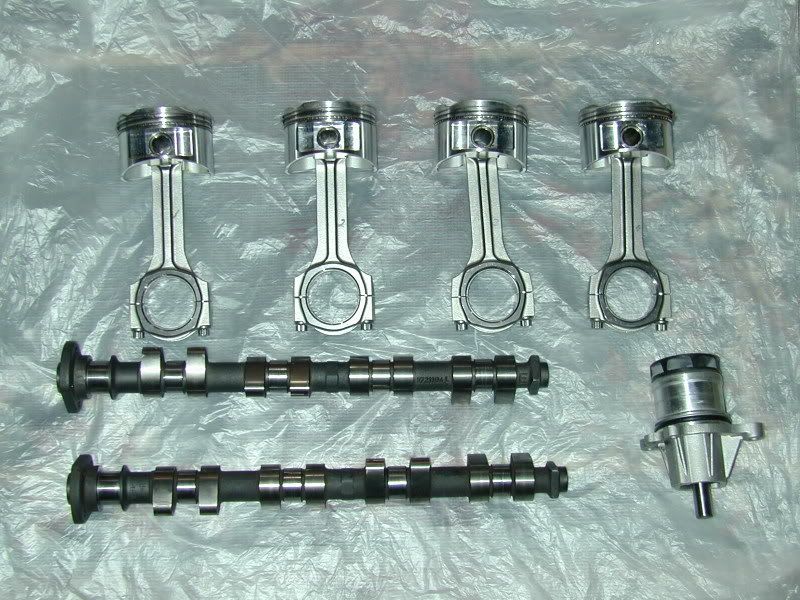

what pistons are those? Any idea what power you're making? And..hmm.. E35 M5?

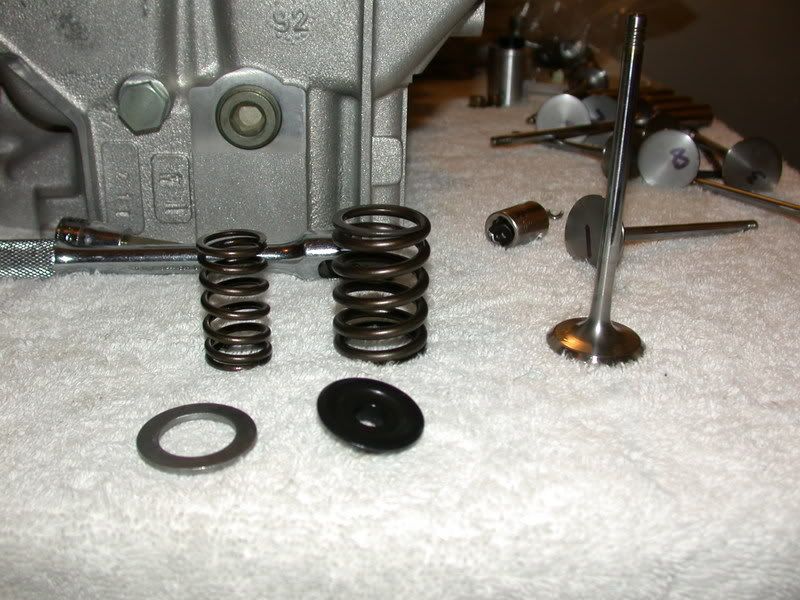

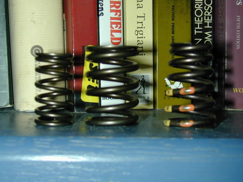

Can you give info about E34 M5 springs? How do they compare in weight and stiffness to M42 springs? Are they straigh swap?

JE 12. 5 to 1, lowered to 11.5 to one with MLS headgasket.
Thanks!!
Hows the megasquirt, was their any difficulties installing it on your car? Did you have problems with the BMW coils, also the did you need a trigger wheel, and also did you assemble it yourself?
Thanks
And as for power i beat my friends 1.8T Jetta pretty hard

For the e34 m5 springs, they are heavier but stiffer same dimensions as e30 m3, so they should be safe to 8000 rpm. I used vacmotorsports.com dual spring retainers, e30 m42 small spring bottom retainers, and a custom made shim/retainer to hold the big spring in place.
Any questions just let me know!
Hey what kinda valves are those stock ? oversize ?

Stock valves.
