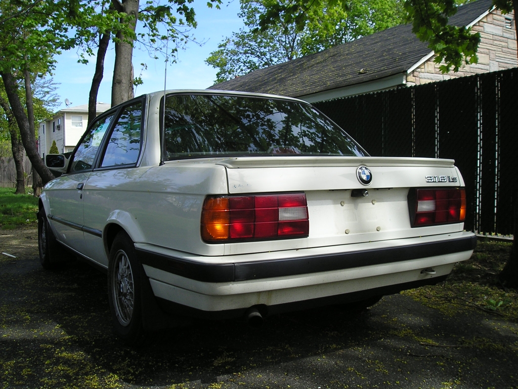

Just recently picked up an E30 318is here in Long Island --- Details below:
'91 318is
Bone stock - 157k miles.

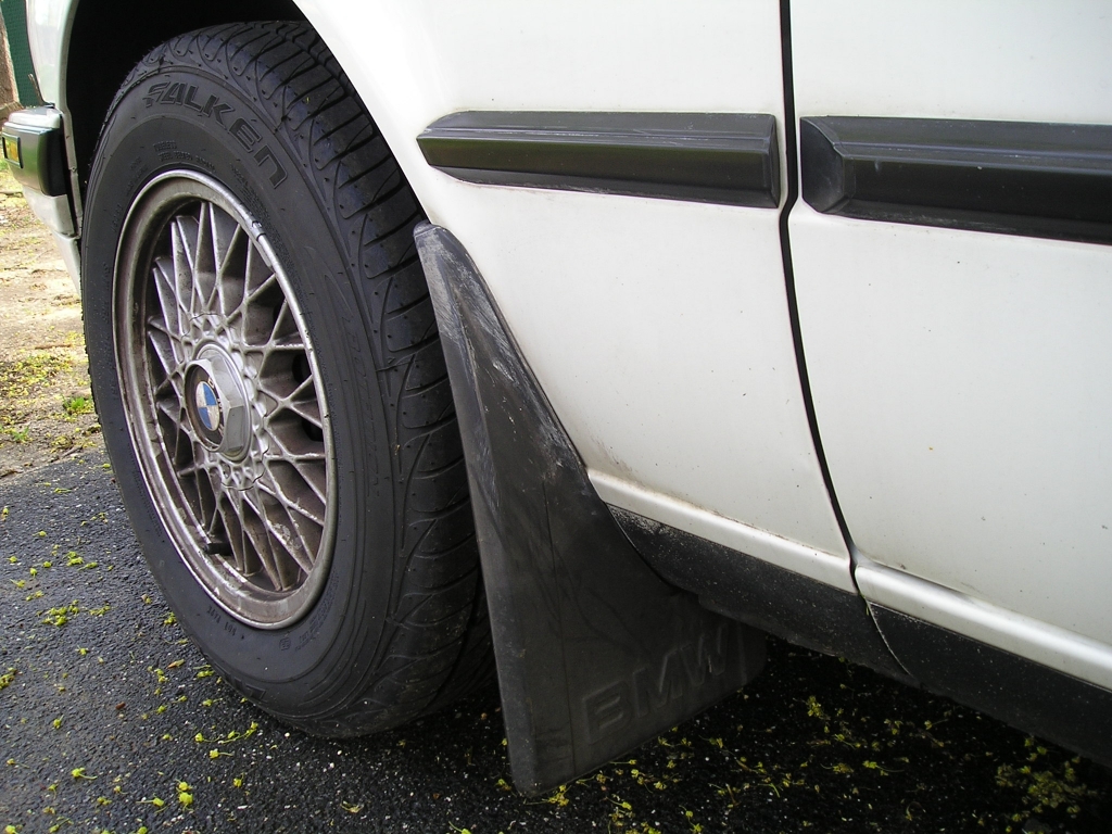

- AlpineWeiss II w/ black vinyl interior
- All the standard 318is goodies - Shadowline trim, 4.10 LSD, manual sunroof, etc
- Less than 200 miles on 14" 'Weaves w/ new Falken Ziex ZE512s
- Set of Bottlecaps w/ BFGoodrich Winter Slalom snow tires included
- Panasonic CD + Sirius head unit w/ Sony front speakers and Blaupunkt rears
- Stock BMW Cassette head unit included
- Detailed records, but only since 94k miles - it's something, I s'pose
- Awesome BMW mudflaps, complete w/ stock suspension - 4x4 insanity crazya.gif
- Equally awesome sealed beam headlights...
- Clear title
Needs:
- A front lip
- Driver's side floormat
- Umm... a working drivetrain
Bought from the second owner for $550. The first owner garaged the car for the entire time he owned it. Well looked after car - very clean underneath and glossy paint.
Unfortunately, it doesn't run. The shop that has been maintaining the car for the last five years says it needs a new head, or a valve job, as the valves are leaking. A compression test found low compression in three cylinders (well below 100#).
I don't know if I agree w/ the diagnosis, but I haven't had an opportunity to dig into the car yet.
Any hints or tips?
Happy to be here - I owned a brilliantrot E30 318is when I lived in Germany - looking forward to getting this one up and running, as I love the M42 cars!
Cheers,
-AJ

Wow looks good man! Glad you got the posting issue sorted out.
Where in L.I. are ya?
There's a couple of us around here that meet up every now and then to just hang out, drink a couple of beers, talk about cars... You know the deal.
Now, your car.
Low compression numbers usually mean the seals are probably done, the rings are damaged or maybe a head gasket is leaking.
You can isolate the issue by doing a Wet Compression Test, a leak-down test, or a vacuum gauge test.
The car looks great btw, where did you find her?

That's a good deal, just keep your eyes peeled for the tans and head.
jpod999
  • Posts: 620
16v of Fury
« Reply #6 on: May 17, 2007, 06:37:00 PM »
Sweet car.  Looks like it's in pretty good condition.

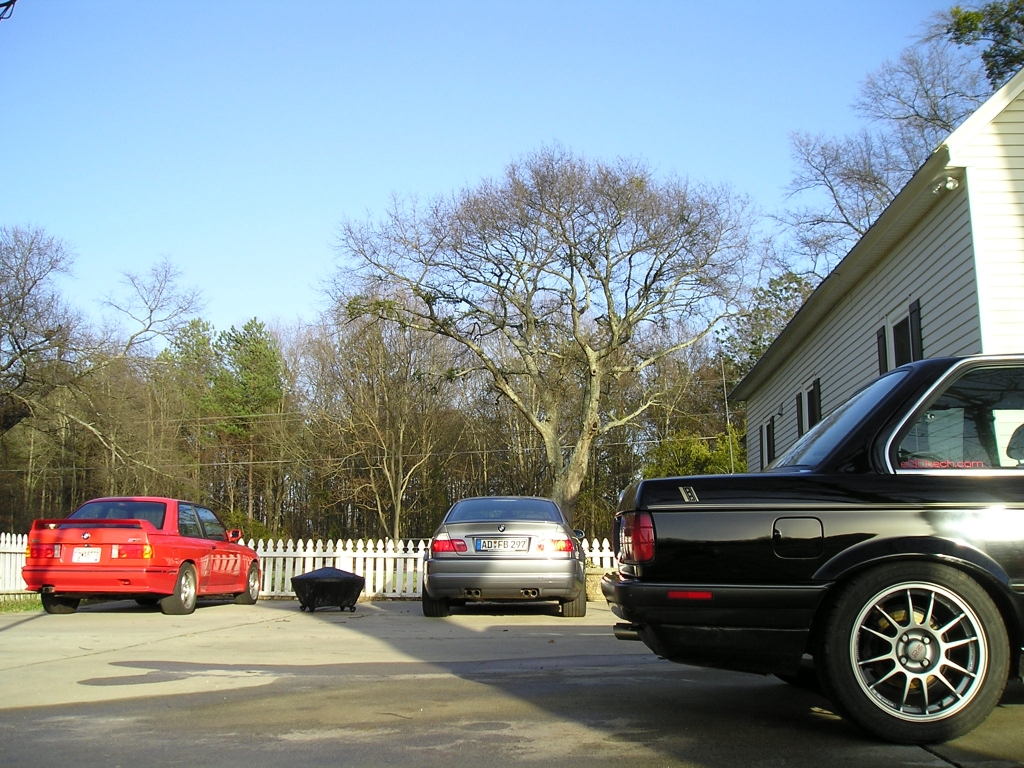

Ok - Here are my other cars:
'88 M3
True Hennarot
Currently wearing 16x7.5 E28 M5 BBS
Otherwise bone stock
81k miles
'89 325i
16x7 OZ Superleggeras
H&R Sports
Stebro catback
True E30 Recaro's (NOT Sport seats)
'05 M3
Eibach Pro Kit + Koni SA's
18k miles - European delivery US-spec car - ordered the car new and received it while stationed in Germany
The Fleet

P.S. Just saw the pics of the "fleet". It appears the madness began long ago!

Yeah, I've been a BMW guy for a loooooong time!  This 318is is my sixth E30!  I've had an '87 325is, '89 MTech2 325i, '91 318is, and the black '89 325i and Henna '88 M3 pictured above :D --- I love E30's!

Are you a lottery winner? I would have a hard time picking one to drive to work! Nice stable you have!
16v of Fury
« Reply #11 on: May 17, 2007, 07:38:56 PM »
Wow, I wish I had the space to kepp a fleet like that. Oh, and I'd probly need a bit more money....
Anyway, welcome to the club. Looks like a great car, hope the engine problems aren't too bad.
BTW I've never seen the E28 wheels on an M3, but they really look awesome, and sleeper.
16v of Fury
« Reply #12 on: May 17, 2007, 07:42:44 PM »
Great selection of cars man!
What happened to those previous 5 spoke rims on the M3, they looked hot!

Haha - no, I'm no lottery winner.  Really, it's not an expensive collection of cars.  The E46 when it was new was a little more than your average fancy SUV soccer moms drive around in.  The E30 M3 was $11k, which is the going rate for a couple year old Honda Civic.  The black E30 was $1800, less than people are spending on plasma TV's.  The 318is was $550 - cheaper than a cheap couch from Rooms To Go :D
Of course, I don't own any SUV's or plasma TV's :D

Thanks Denis!
They are Momo Star's --- real '80's wheels!  I have them down in the basement, they were on the car when I bought it.  I'm not going to put them back on - I like BBS much better!
