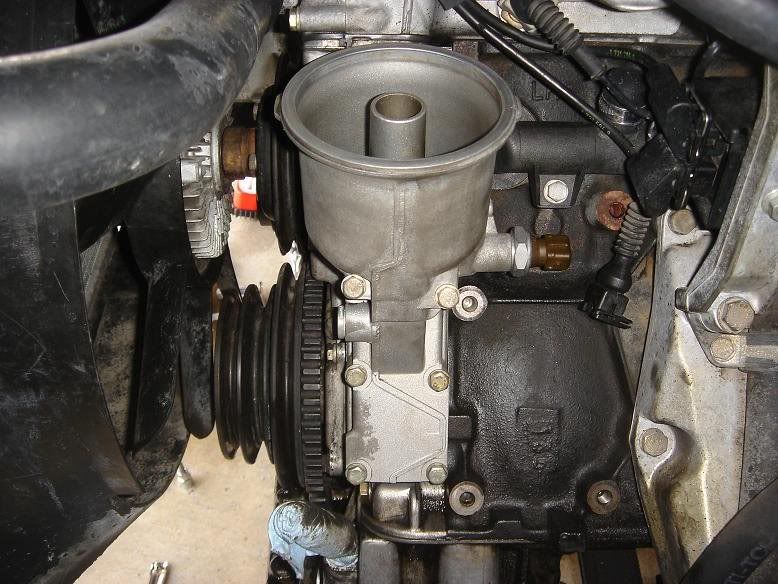

OK, so I decided to go this route instead of just changing all the cracked lines like I was originally planning.  Looks sooo much cleaner with just the plastic tube and the one coolant line from the block to the the plastic tube.
Man, so much gunk in the ports and lower manifold!  What's good to clean them out?  Brake cleaner + brush?
Also I live in NJ, so I guess I'll guinea and let you guys know if I run into problems down the line in the winter.  I'll be keeping the heater stuff in case one bitter morning the throttle ices up.
