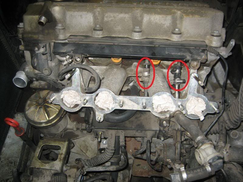

I see fuel hose listed in the parts.  What is that for?
She loved E
  • Posts: 72
The mess under the intake
« Reply #166 on: October 30, 2009, 03:09:43 PM »
The two short fuel hoses on the fuel rail.
Kyle / M42 / M119
KenC
  • Posts: 498
« Reply #167 on: October 30, 2009, 04:01:06 PM »
Just to replace them? Or do they need to be lengthened?
  • -Receive: 5
  • Posts: 1109
« Reply #168 on: October 30, 2009, 04:11:50 PM »
Its just a good times to replace these while you're in there. They are hard to access otherwise.
