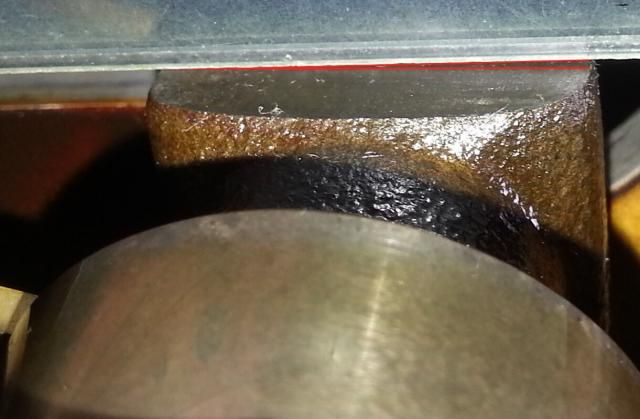

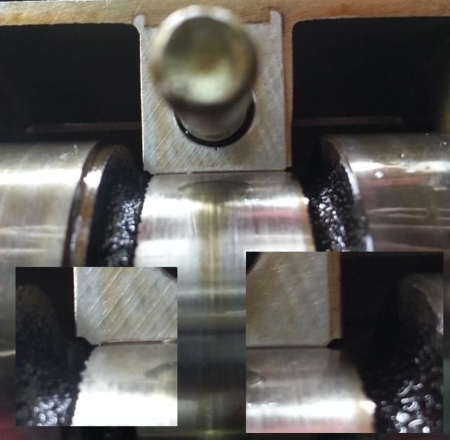

I noticed other details when I removed the cylinder head cover :
The two camshafts are slightly shifted (right word ?) towards the right side = the chain side.
The camshafts are not perfectly aligned. What is the tolerance ?
Could this explain the noises and vibrations ?

By no means am I an engine expert, but I would suspect your noise is from extremely worn timing chain components. The pointed timing chain sprockets is one pretty good indicator. If you have a mechanic's stethoscope, use a wooden dowel held against your ear and probe the surface of the engine. You can pinpoint the area of noise pretty accurately and diagnose from there.
As far as your "cam shift" question, I don't believe that has any significance in regards to your concerns.
