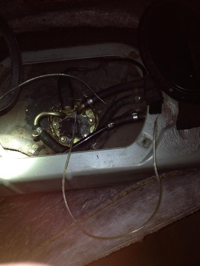

Heres a picture of how i wired the fuel pump directly to the battery

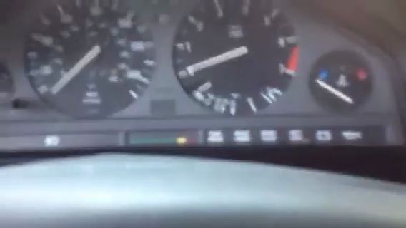

Heres a video of what happens when i do the press gas 5 times in 5 sec

Heres part 2. same vid just wouldn't let me email myself the whole thing
That's your fuel level sensor. Pull the other connector and with the key turned to "On" check for power: pin 2 (green/violet) is hot, pin 1 (brown) is ground.
whoops.. alright will check the other one thanks

You're welcome. If it turns out to be a bad pump you'll have to pull the sensor out first in order to pull the rest of the assembly.
