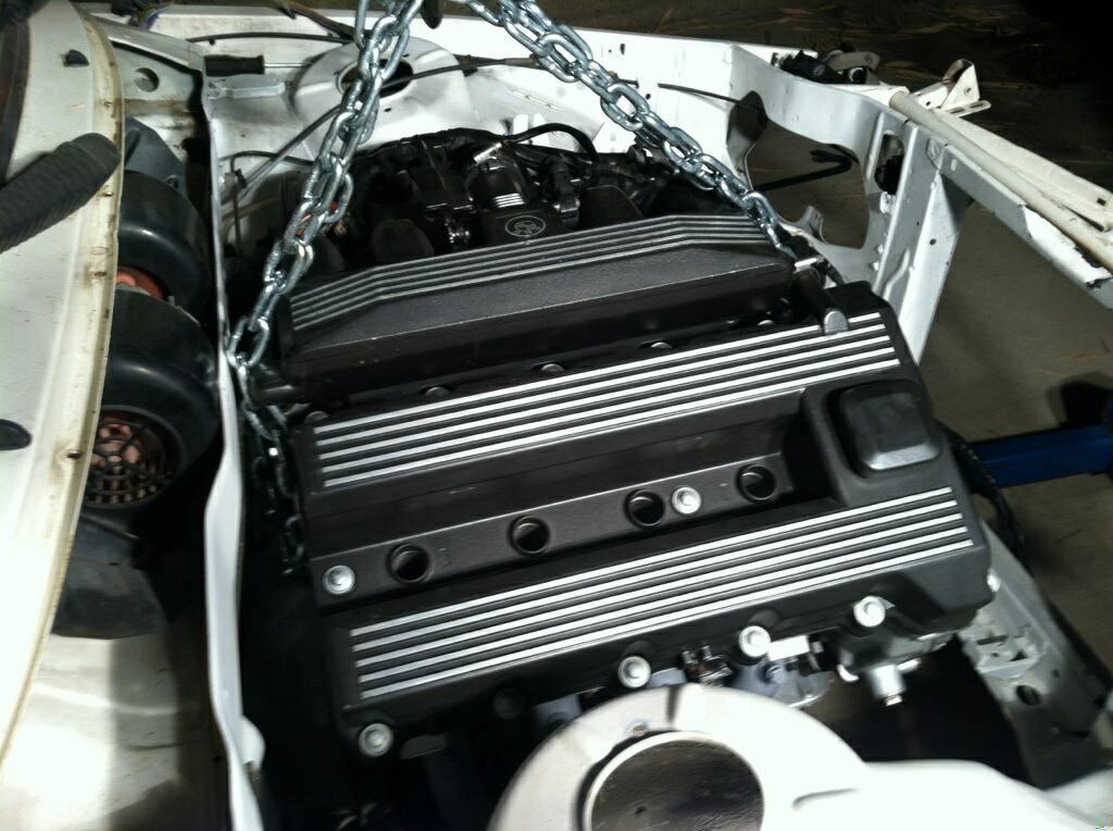

Why have you got the rocket cover breather going into the sump?

lol, its an illusion. The vacuum hose from the valve cover is going to the throttle body, but in the picture, the oil dip stick tube blends in with the hose.

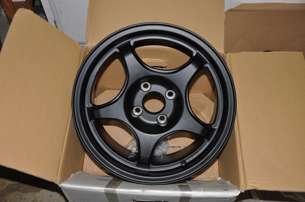

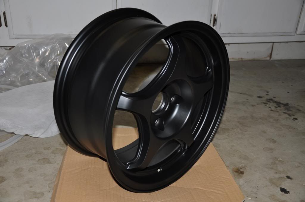

Working on wiring at this point, but also pending other parts that i need. In the meantime, for the sake of an update...
I got a hold of some 15x7, et15, D-Force SPEC-E30 wheels. They're light weight. This will make up in what i lack in horsepower.
Not a flashy kind of guy, so i opted to go with a discreet look. One day I'll have some nice daily driving wheels...but not right now.

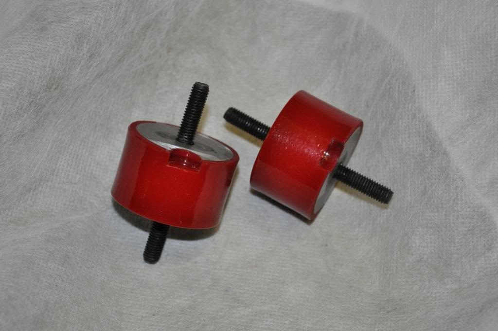

Since i am using this car for the track, i also got a hold of some solid transmission mounts from UUC for the Getrag 240.
