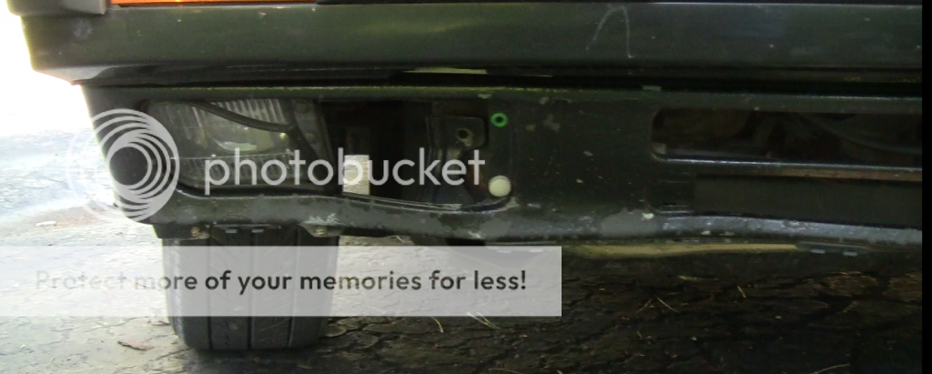

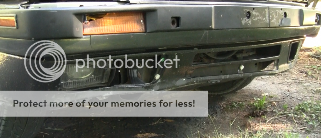

Okay guys I have a question, I am doing a little body work and I am trying to get the front valance off. Do I have to take the front bumper off to get to it? If so, whoever took it off/put it on last stripped both of the main bolts holding the bumper on, how do I go about getting this bugger off?

If those bumper bolts are stripped, they're a bitch to get at. They use a pretty big socket head bolt (10mm? allen key/hex head), but those sockets tend to get rusted out. Sometimes they're easy, other times they're impossible. You can't use heat because the bumper and core are plastic. You'll need an eazy-out along with a selection of left-handed bits. I prefer the square ones.
You can't get at them even if you remove the bumper cover, although that might be a good idea to protect it. The cover is only attached to the core with a bunch of those plastic expanding push-pins.
The bumper slides into two large clips on the quarters, I'm not sure how you'd get them off without removing the bumper first. There are also two fasteners in front holding the facia onto the quarter panels. There are also a few hidden fasteners inside each quarter, just forward of the door hinges.

« Reply #26 on: September 08, 2014, 04:14:09 PM »
Alright, here is what I am dealing with:
I guess I will have to get a set of easy-out drill bits like you said, those bumper bolts are stripped like no ones business. What are the left handed bits for?
