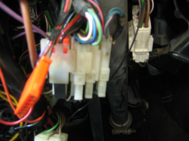

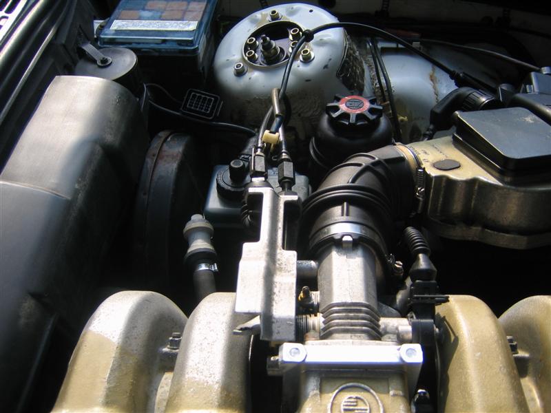

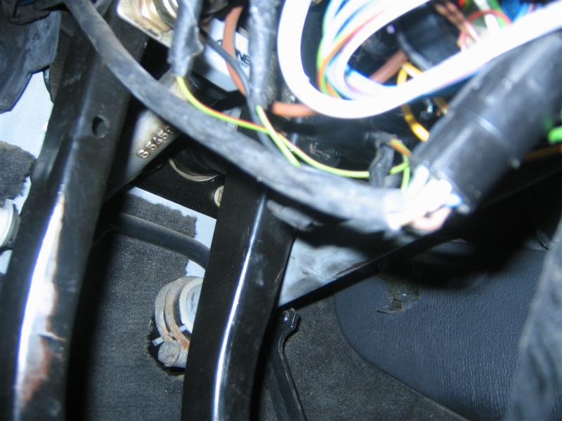

« Reply #33 on: May 20, 2006, 09:37:10 AM »

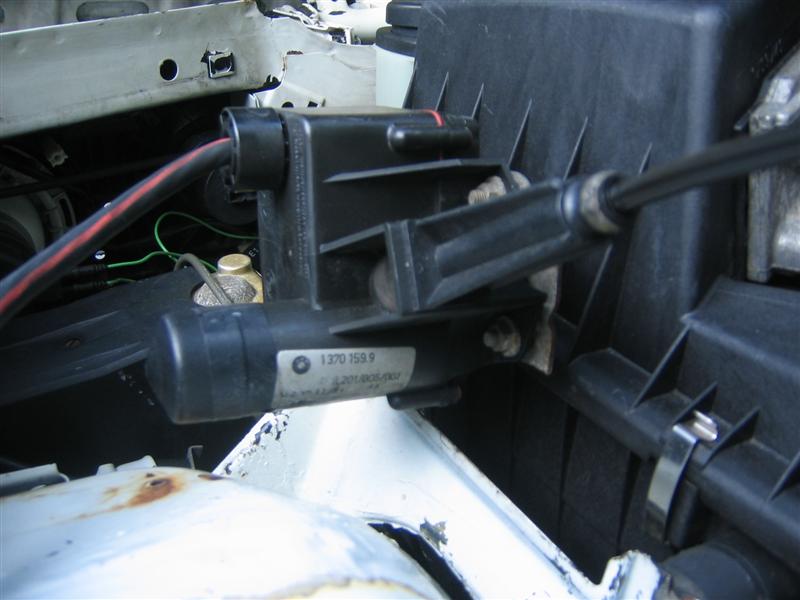

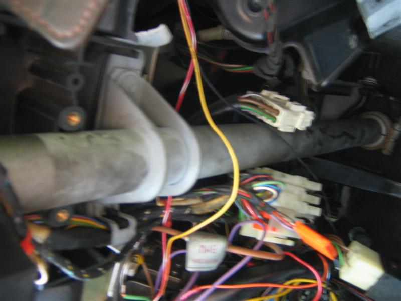

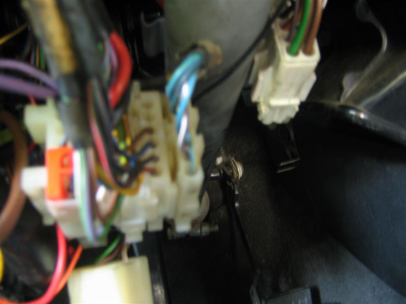

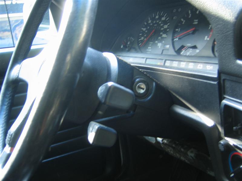

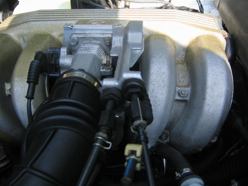

Sending you pics now...your assumption seems to be correct for the mix of e36 mechanicals under the hood and e30 controls in the cabin.
e9nine
  • Posts: 674
Definitive Cruise control Thread
« Reply #34 on: May 21, 2006, 08:14:37 AM »

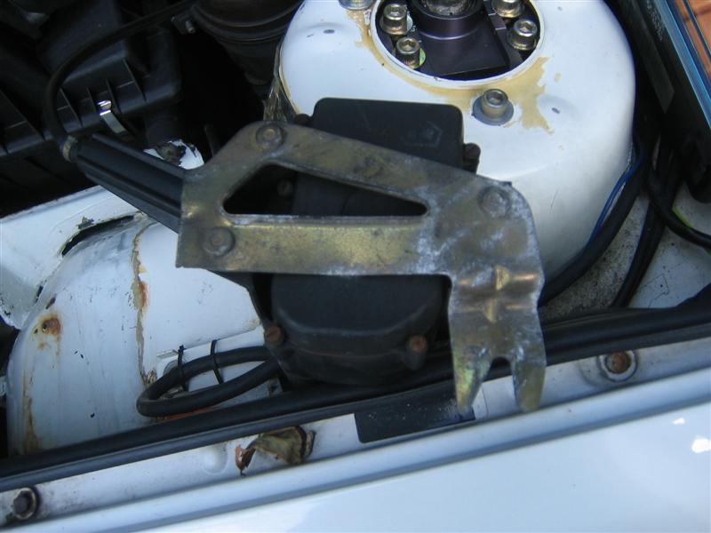

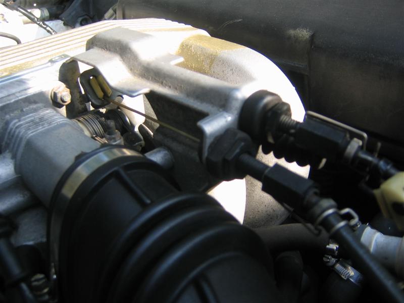

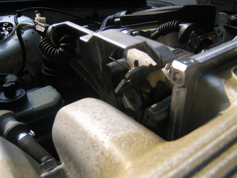

BTW - The throttle bracket is the same. The cable is just routed the opposite way with the cruise setup. PN 13541727147 applies to e36 and e30 cars.

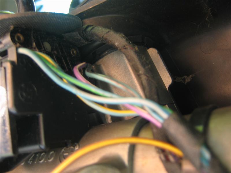

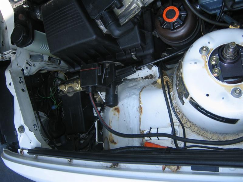

Quote from: e9nine
The part we need to see, the cruise computer is behind the glove compartment...
You mentioned that you were ripping it all out of your car and potentially putting it in your other E30?  When you do that, we can get a good look at the other components - the cruise computer, the wiring harness, and the clutch/brake switch.

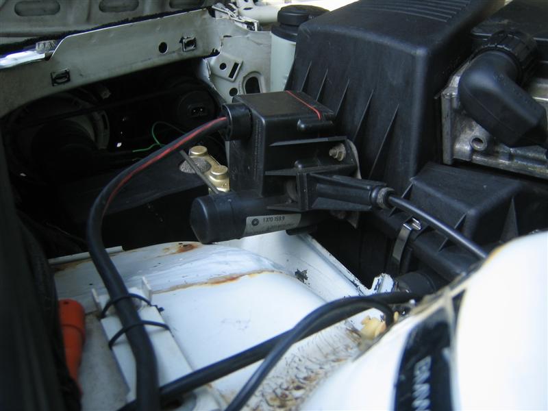

The Tempomat installation becomes following into a 318i M40 Touring transmission (no Tempomat preparation). The VDO is blocked compactly speed act.
1. Assembly of the actuator (inclusive control electronics)
· The 3 point base plate somewhat modify and onto the front mounting plate of the air cleaner with screw
· The actuator is to look with cable assembly toward tail
· Cable assembly shorten and in light elbow to the gas modulator at the engine lead
· Cable assembly by the second hole pull
· The course to the original course fasten
· The coat of the cable assembly at the original coat with provided clamp fix. Note: not too firmly
  screw on, otherwise one wedges the gas courses
· Cable assembly now with cable straps fix. Tap: if one the cable assembly before the actuator at one
  immovable point fixed, no vibration to the actuator transferred => longer lifetime, improves

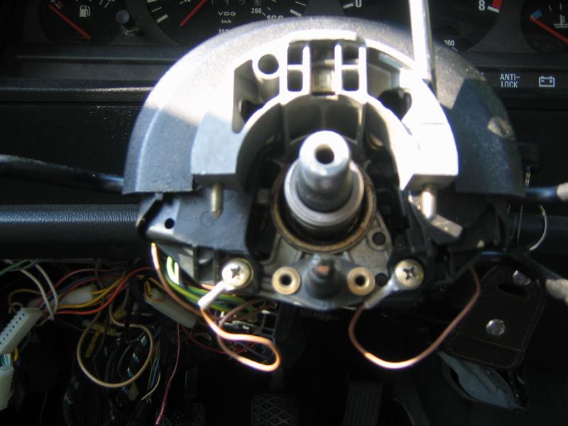

6. Steering column switches install
· Lower steering column cover off (there the steering wheel must also also off)
· There lever a Vorprägung on the inside of the lower is left under+behind half from the windshield wiper
  Steering column cover.
· Hole bore
· Levers accomplish
· Levers bend in such a way that it sits correctly
· Bolting on
· Lining again to
