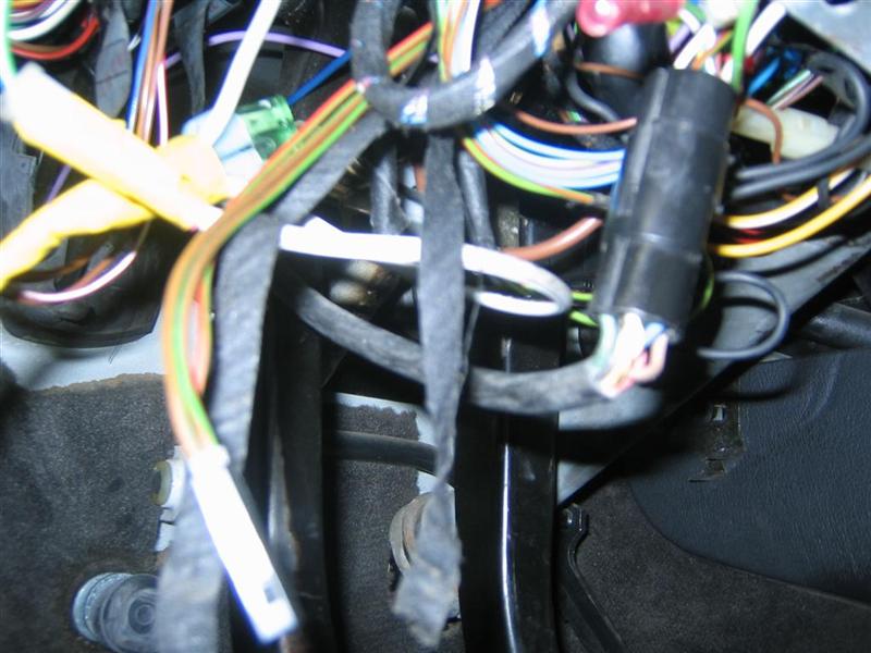

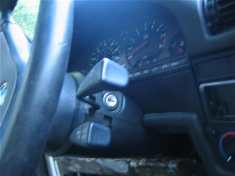

Zoso - I got off my butt and took some pics for you. Too lazy to resize them so send me your e-mail address via PM and I'll send them zipped for you to do as you please. I have pics of the actuator, throttle cable part, the connector and the stalk wiring.

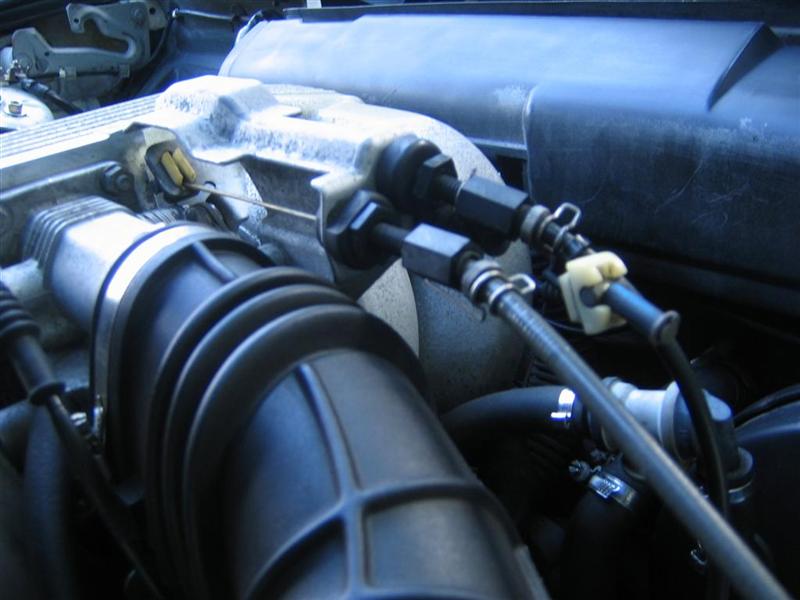

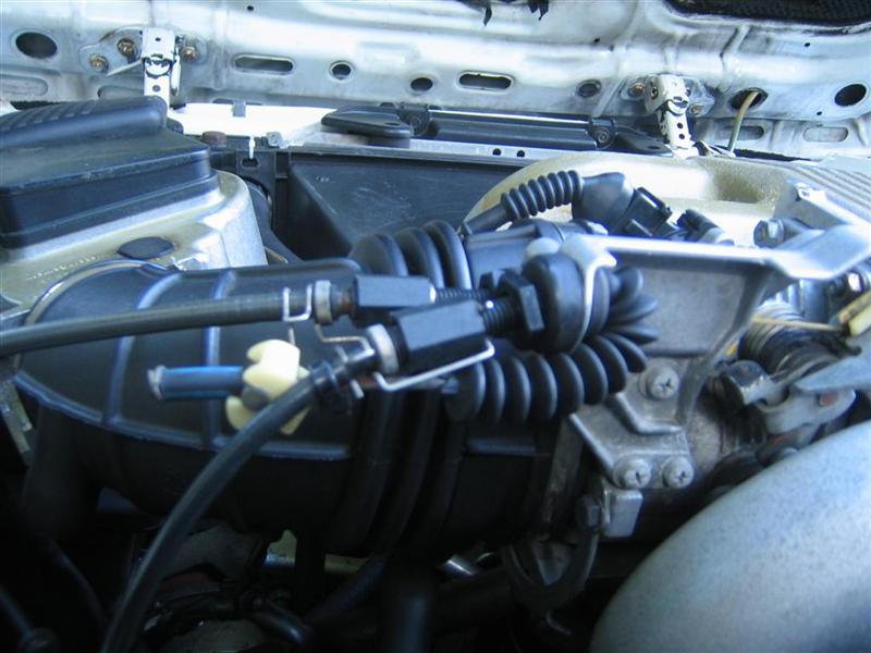

Throttle body/Cruise cable clip: My cruise is disconnected as I don't use it. I have no intention to reconnect it and might swap it into my other m42.
Pic with wires...you will see the cylindrical shaped connector...that's where it connects to the cruise harness. I have not yet gone into my wiring yet as there's no reason but I have a spare cruise unit I gave to a friend which he isn't gonna use so I'll pick that up and take pics for you guys (might be about a week...)

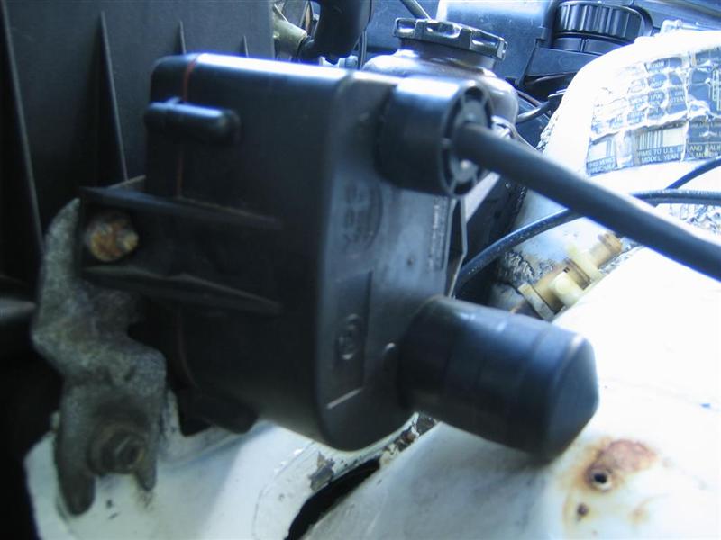

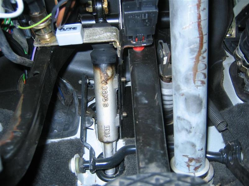

There are 2 wires that leave the actuator; one goes to the throttle body bracket and the other one goes into the car via firewall. I believe it's close to where the master cyl for the clutch is and you will see a rubber plug you can perforate when the time comes.

Here's the throttle body linkage:
Again, it is an E36 m42 based 318i part:

It looks to me that the actuator itself:
is really the E36 M42 based 318i actuator:
This is the E30 325 actuator - notice the different mounting brackets:
Thanks E9 - those pictures are EXTEMELY helpful!
